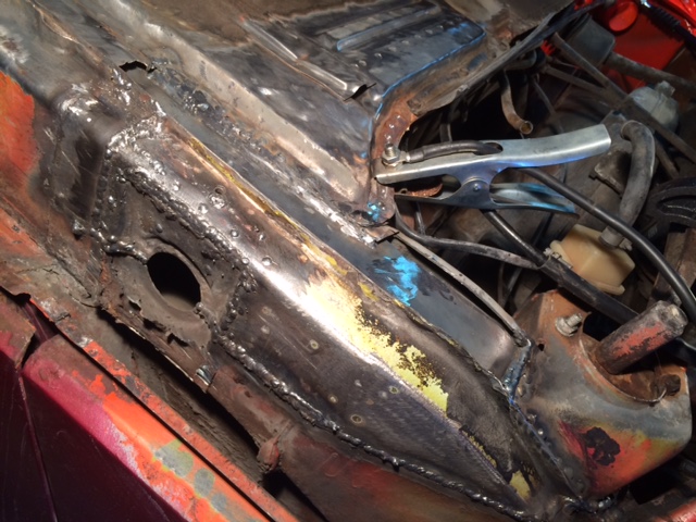

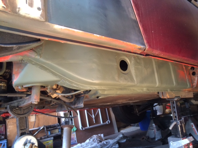

marksteinhilber
post Oct 5 2016, 02:04 PM
Posts: 229
Joined: 18-October 12
From: Foothill Ranch, CA 92610
Member No.: 15,057
I learned plenty from this website. Jack point repair can be done with just a hole cut below the door latchplate. Outside long can be overlayed by carefully removing triangle plates and sill. I've been able to reuse those pieces as I was careful how I used a spot weld cutter and thin cutting wheels. I use a 4 1/2 grinder, 3 inch electric die grinder, and a dremel, each with thin metal cutting wheels. Here, I'm ready to put the overlays and the new jack point parts from RD into place.Attached Image Attached Image
