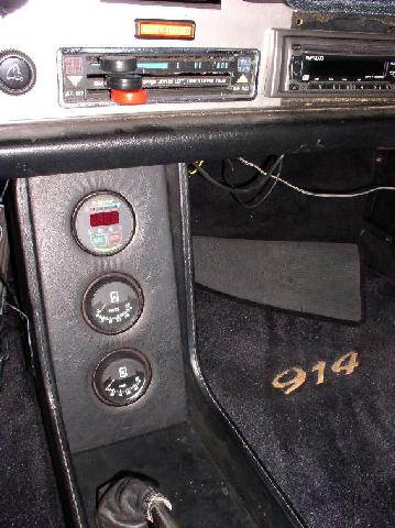

Big Boggs, these are my gauges: Bottom one is an ammeter, middle is a voltmeter, and top is an E-meter. The E-meter is a fancy gas gauge. It tells me the amphours leaving the pack and returned to it on charge.
