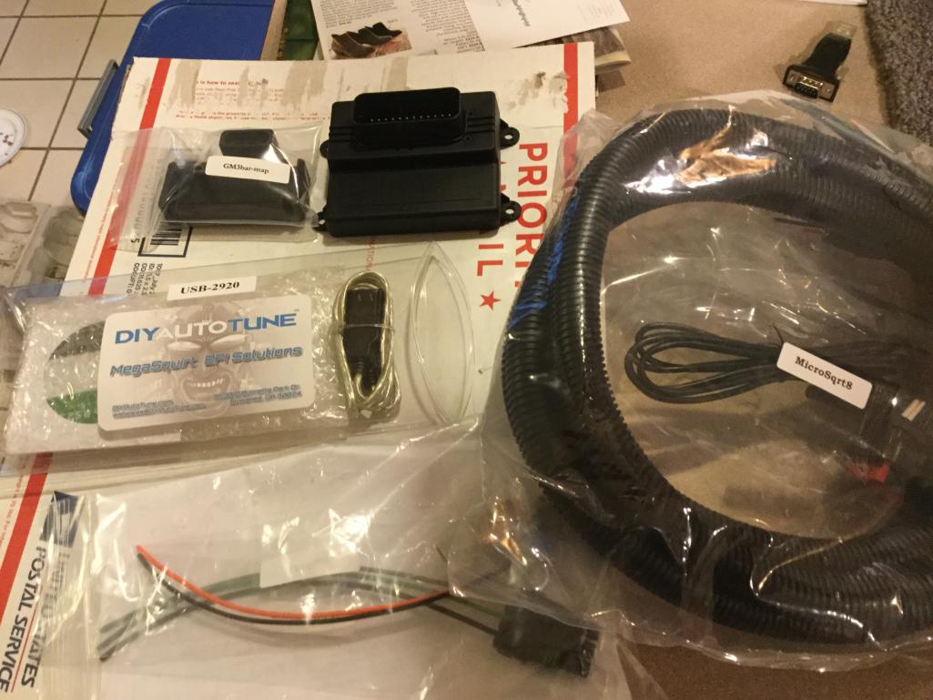

I am pretty happy with my stock FI. But after seeing some of the setups at Okteenerfest, I thought this might be worth trying.
The stock system is not easy to modify and get things running correctly. I spent a lot of time making minor adjustments by trial and error. While I am not looking for huge HP gains or anything, it is pretty clear that the mods I have could potentially benefit from a bit more precise control.
Going to start with fuel only at this point to get things going and see where it leads me. Any help or suggestions for set up would be appreciated.

First box of goodies!
