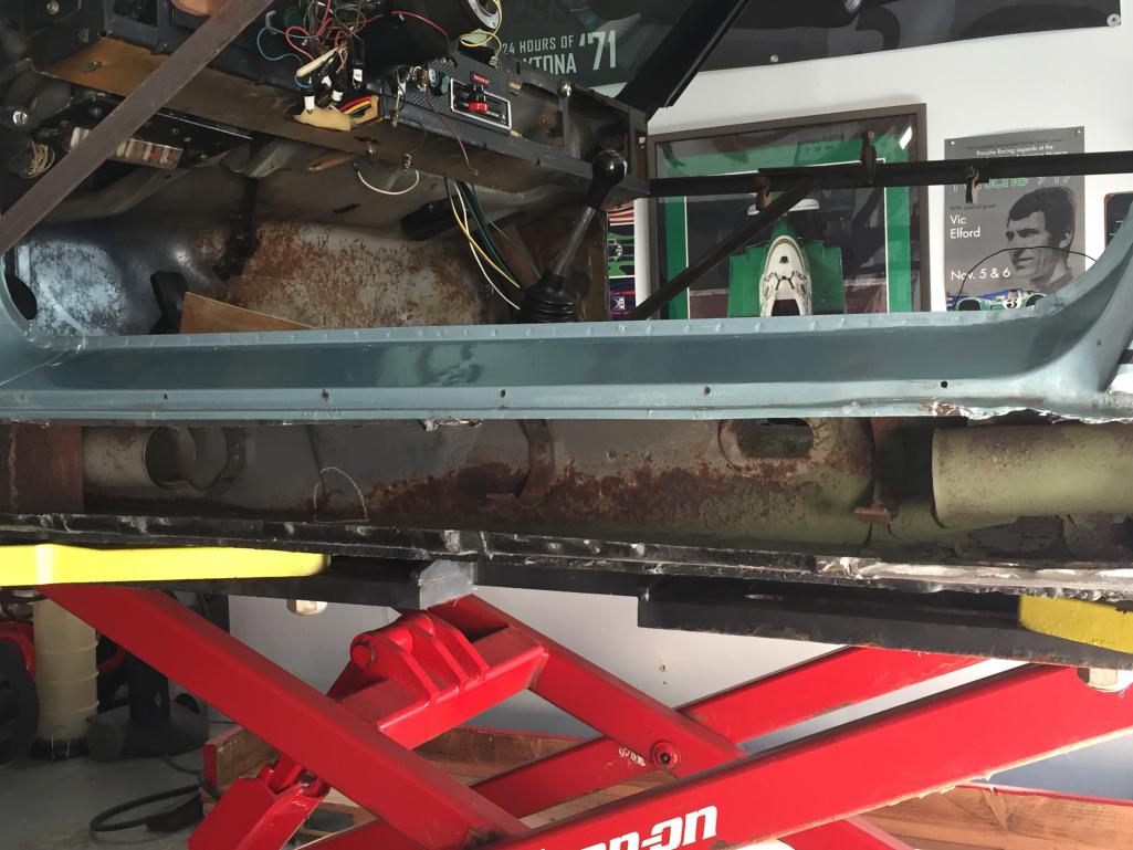

Well I've started the process of preparing for
my 2056 GT to 2.4L six "rallye tribute" auto.
Tearing into the interior I discovered some rust mites have been eating for a while.
Doesn't look too extensive but will be probing some more. The exterior left long was
patched a long time ago, albeit incorrectly. This was done by shop
that wasn't fully up to speed on these cars and I was still a novice, well
still am. I'll be doing some exploratory surgery on this left side inside and out. So I'll get this addressed before any engine install takes place. Would like to
have it buttoned up for Hershey 2017. Wish me luck.

Opened up whole of left longitudinal today. I'll be ordering some metal
for the U-boat. I'll be replacing the sill,door jamb, rocker outer cover,
the rear jack donut and inner rear lower firewall.
Dave lent me his spot weld remover bits so that's where I'll begin.
Then I'll address a "hatch" for the six to adjust the timing. Lots of work ahead.
Many of you guys have been here before. Wish me luck.
This will be going at the same time as reassembling Dave's GT. So little time!

Dion   Cut away the remainder of the sill panel. Surface ...   Dec 1 2016, 01:29 PM
Dion   Removed more of the door jamb except for brace are...   Dec 1 2016, 01:37 PM
Dion   Pics   Dec 1 2016, 01:41 PM
Dion   Pics   Dec 1 2016, 01:43 PM
Dion   New firewall panel test-fit & de-brazed E-brak...   Dec 1 2016, 01:44 PM
