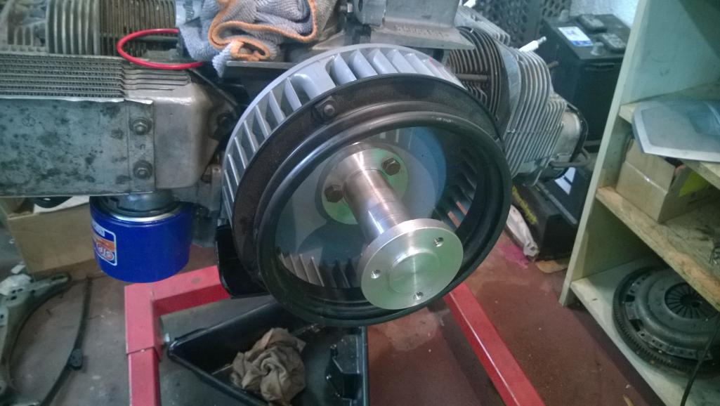

Hi,
This problem is a distributor issue. I guess if you go thru the trouble of locking it down, it would be less of an issue. It isn't likely that you will see a problem with a cam position sensor.
When you look at the time, effort and money to implement a imperfect mechanical solution, it doesn't make sense. It's applying yesterdays technology today. It would be different if you already had these parts in hand.
I think you started down this distributor road because of AC. I am 99.9 % certain that the stock AC pulley is not an issue with Original Customs trigger wheel setup. I either gleaned that here or discussed it directly with Mark.
I attached a pic of the AC adaptor that I will be using.
