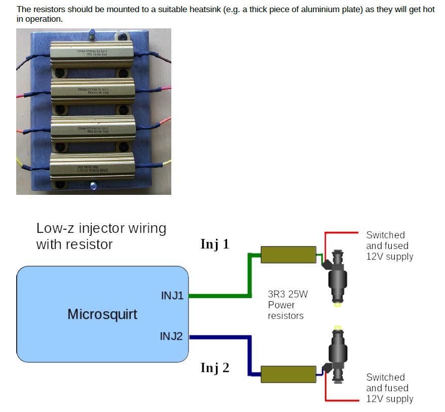

Ok let’s be clear. I am not no wiring expert! But as I understand things the micro squirt controls the injectors by providing ground. Meaning the controller switches ground on an off as needed to fire the injectors. Because I have low impedance injectors I have to use resistors. Below is the guidance from the manual on how to wire.
Based on this it shows the resistors on the controller side which is ground. (IMG:style_emoticons/default/WTF.gif)
This can’t be correct can it? Especially when it stats than an individual resistor is required for each injector.
The resistors have to go on the 12v wire don't they?

QUOTE(Mblizzard @ Oct 7 2016, 10:59 AM) *
The order of devices in series is immaterial.
Question, how much voltage and current at are the injectors designed for?
What is the current the MS is designed to sink?

QUOTE(N_Jay @ Oct 7 2016, 08:03 AM) *
Lets say the injector resistance is around 2.5 Ohms and I am adding another 3 Ohms so that would be about 2 amps based on 12V.
