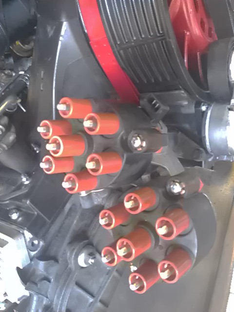

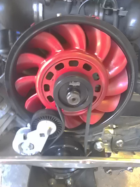

New picts of progress
Clewett 964 Serpentine belt kit
Rebuilt distributor installed.

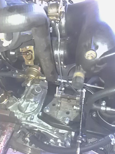

Custom Throttle linkage.
The throttle linkage uses a stock 914-6 cable and a bell crank assembly from a 964 Turbo. Custom uplink to the throttle body. Hooked it to the cable in the car to test the geometry and the pedal pressure.
