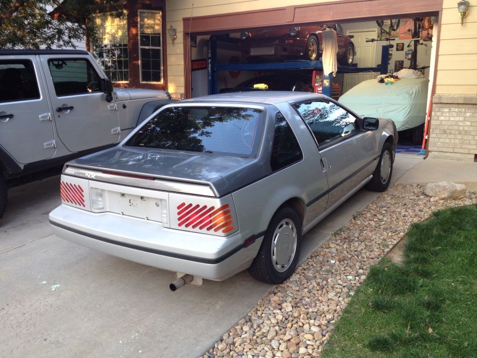

Here was mine, found 2 years ago. Same deal low miles 74k, but after a bit the trans popped out of 5th. Sold it to the mechanic for what I paid.

Ferg   Do I spy a Pulsar? :Qarl:   Oct 9 2016, 02:00 PM
ClayPerrine   Do I spy a Pulsar? :Qarl: Yep... Good Eye. I...   Oct 9 2016, 07:49 PM
Ferg   Here was mine, found 2 years ago. Same deal low m...   Oct 10 2016, 02:02 PM
rhodyguy   Those GTiRs are pretty cool. The AWD version must ...   Oct 10 2016, 06:49 PM
