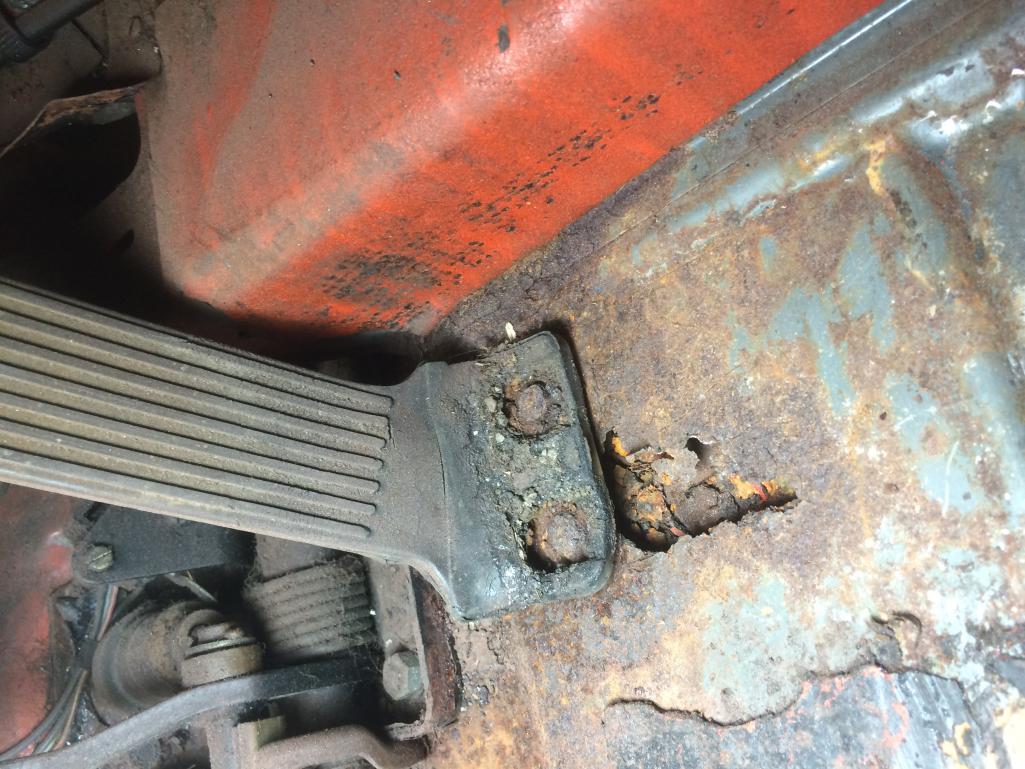

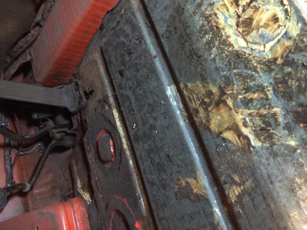

As I continue the refurbishment of my '74 914, I notice that the floor pan inside the car has some kind of a 3/16" protective coating. Parts of this have chipped away. Does anyone have a substitute application to patch and restore the floor pan?

you may see like these under tar.

jcd914   It appears that it was applied[b] right over the...   Oct 15 2016, 12:37 PM

slotty008   It's a pain to remove the tar coating . But I ...   Oct 15 2016, 01:28 PM
