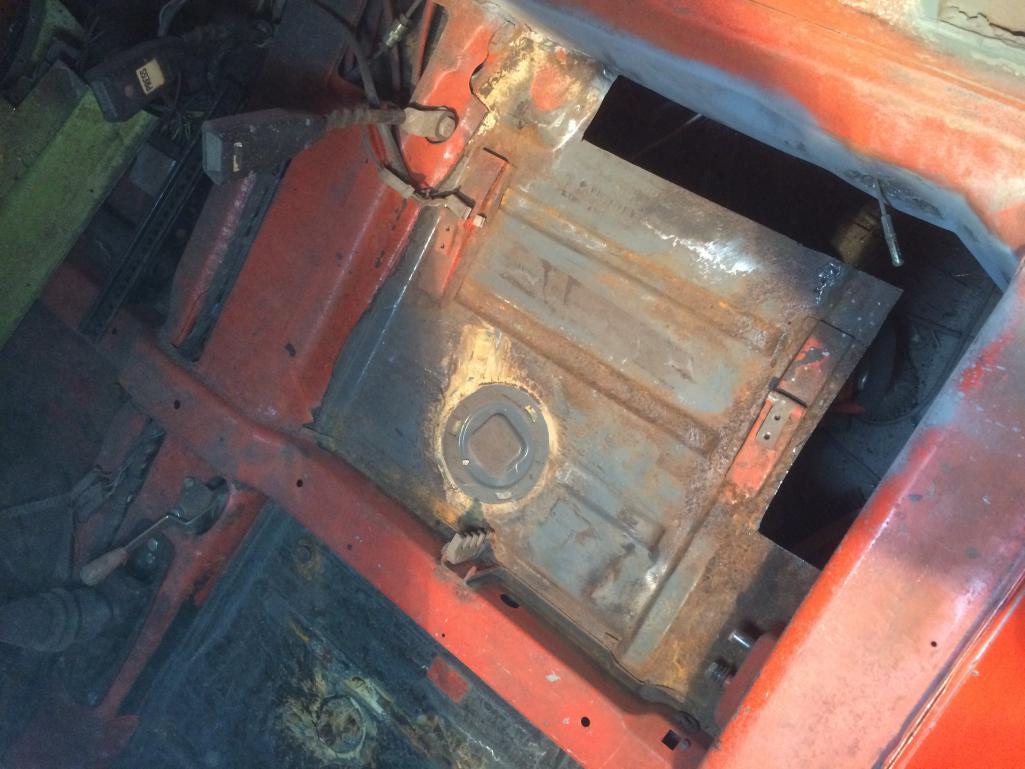

As I continue the refurbishment of my '74 914, I notice that the floor pan inside the car has some kind of a 3/16" protective coating. Parts of this have chipped away. Does anyone have a substitute application to patch and restore the floor pan?

dgraves   Floor Pan Coating?   Oct 15 2016, 09:50 AM
Mikey914   It's basically a tar pad. They are known to ha...   Oct 15 2016, 10:54 AM
dgraves   Thank you. Luckily, the car is pretty rust free a...   Oct 15 2016, 11:54 AM
BeatNavy   Do you know what was used in the areas where the ...   Oct 15 2016, 12:07 PM
jcd914   It appears that it was applied[b] right over the...   Oct 15 2016, 12:37 PM
Mikey914   If you really want to protect it, I'd have it ...   Oct 15 2016, 12:12 PM
slotty008   It's a pain to remove the tar coating . But I ...   Oct 15 2016, 01:28 PM
ndfrigi   you may see like these under tar.   Oct 15 2016, 02:24 PM
ndfrigi   RE: Floor Pan Coating?   Oct 15 2016, 02:25 PM
Mr.Nobody   What are people's thoughts on the best way to ...   Oct 15 2016, 05:06 PM
matthepcat   Heat gun and large screw driver or chisel worked f...   Oct 15 2016, 05:22 PM
stevegm   Heat gun and large screw driver or chisel worked ...   Oct 15 2016, 05:47 PM
bandjoey   $39 multi tool at Harbor Freight. It cuts the...   Oct 15 2016, 10:52 PM
draganc   $39 multi tool at Harbor Freight. It cuts th...   Oct 16 2016, 07:19 PM
cary   My .02c. Heat gun and multi-tool or air chisel. Yo...   Oct 16 2016, 06:54 AM
mepstein   My .02c. Heat gun and multi-tool or air chisel. Y...   Oct 16 2016, 07:33 AM
cary   I plan to try that on the next race car strip down...   Oct 16 2016, 07:48 AM
74ravenna   I hate to ask but does anyone know what the ...   Oct 16 2016, 08:08 AM
74ravenna   Did porsche use this method of coating on the 911s...   Oct 16 2016, 10:59 AM
cary   Did porsche use this method of coating on the 911...   Oct 16 2016, 07:44 PM
rmdinmd   As long as the fibers don't float in the air y...   Oct 16 2016, 05:22 PM
tomeric914   If you don't want to to use an adhesive backed...   Oct 16 2016, 05:35 PM
dgraves   Spectrum? Ok, I'll look into it. The tar has...   Oct 16 2016, 05:42 PM
74ravenna   Spectrum? Ok, I'll look into it. The tar ha...   Oct 16 2016, 07:18 PM
