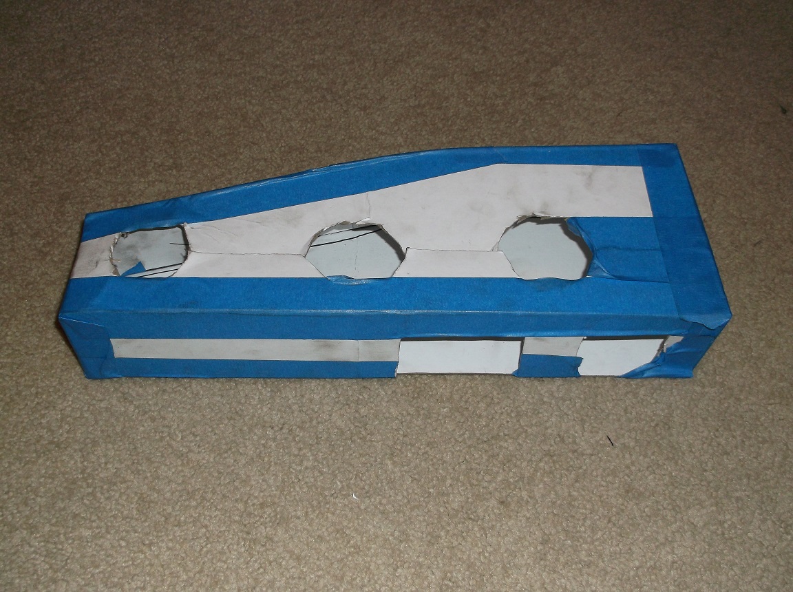

Today was "Arts and Crafts" day....
I made this
This is a rough template made from posterboard to make left heater boxe for my headers. I will be taking this apart to determine the best way to bend the stainless sheet. The right will be slightly different due to the differences in the headers side to side.
The openings for the exhaust tubes will be drilled with 1 34 inch hole saw. The slots in the side will be drilled with the same hole saw, but elongated to let the exhaust pipe out.
The small end will have a 2 1/4 inch tube attached to it to mount the heater box. The big end of the tapered side will have a 2 /14 inch tube with a 90 dfegree bend attached to it to feed air into the end of the heater box. The tube will run parallel to the tapered side, and will come as far forward as the front of the heater box. I will use hoses to attach to the blower feed in the front engine tin. The factory 964 blower tubing will be used on top of the motor to provide air.
Fabricating the heating stuff is slow going. Lots of false steps in the process. It will work out in the long run though.
