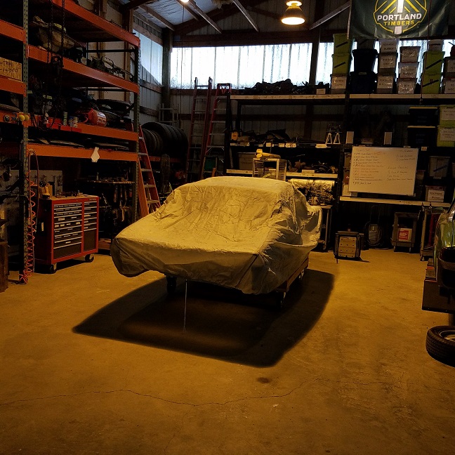

cary
post Oct 15 2016, 09:15 PM
Posts: 3,900
Joined: 26-January 04
From: Sherwood Oregon
Member No.: 1,608
Like always, I ran into a few more issues on Mark's car. (IMG:style_emoticons/default/sad.gif)
Mark's car is not ready to go home yet, but onto Doug's car we go.
The star of the show ..................
New episode of Tool Whore. I will be purchasing a Snap On PTS1000 for the heavy lifting. It has a dual chuck that allows you to use Sawzall blades with it.
