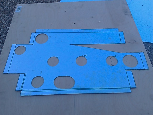

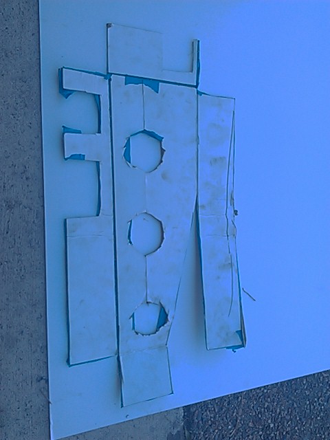

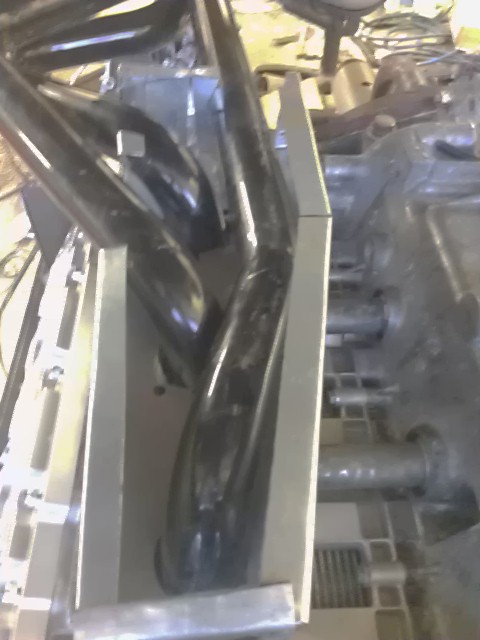

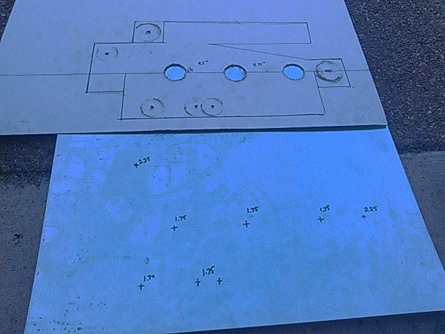

Did some work on the left heater box.
Transferring the template.
Layout work
completed template
And the heater box test fit on the header.
This is the prototype, and will be scrapped, for two reasons.
1. I made all the holes too small and they had to be opened up with a grinder. They look terrible
2. I was told this was stainless, but it turns out it is just galvanized steel.
I will build another one out of the galvanized, taking what I learned on this one and refine the design. Then I will make one out of stainless.
