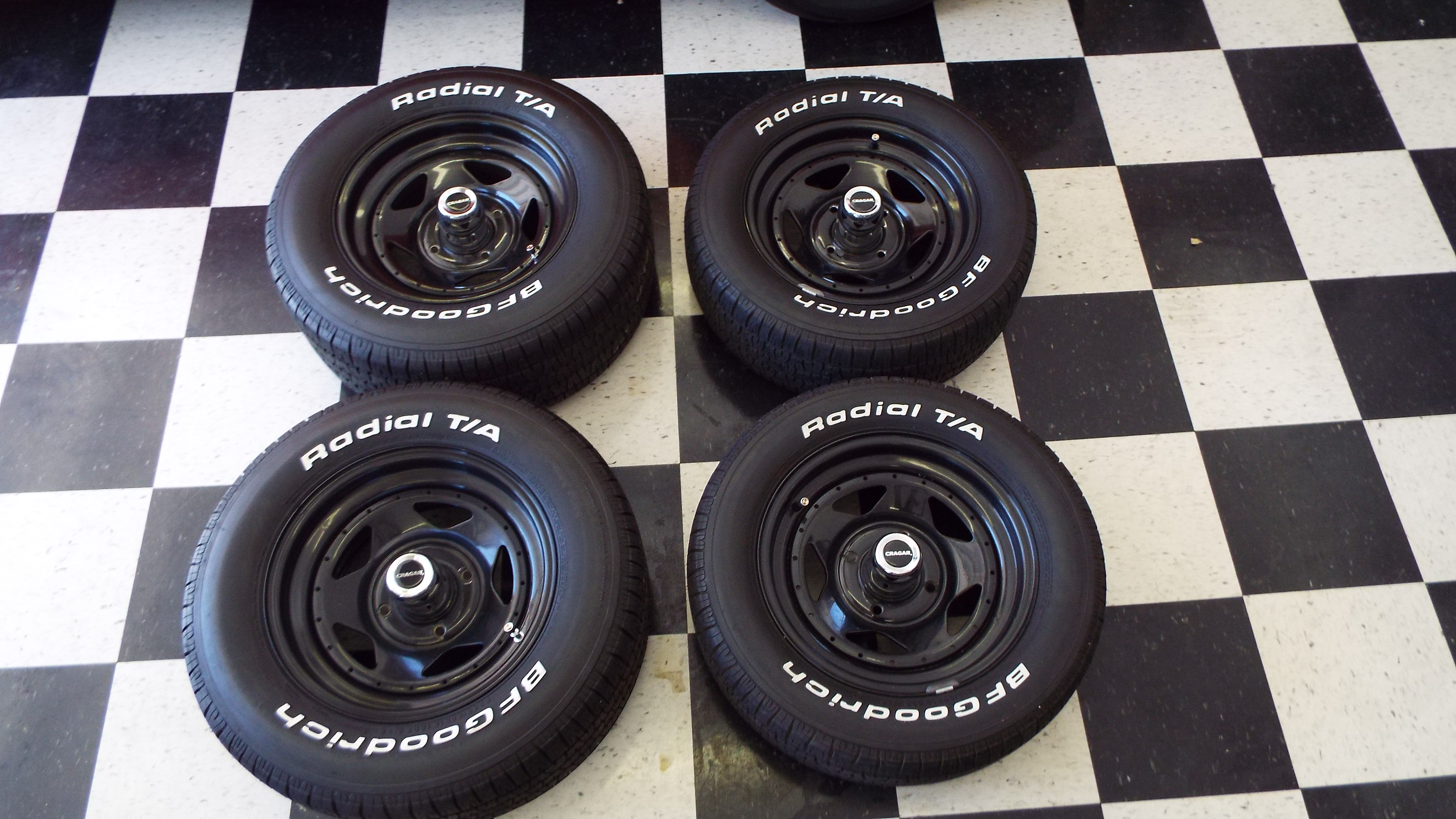

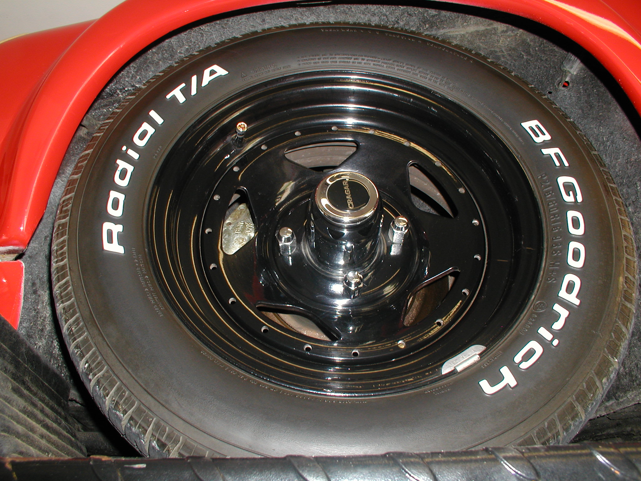

So you are going 7" and 8" and keeping it 4 lug? I have done it with Cragar 365s. I now have 5 lug wheels on the flared car.

QUOTE(Kansas 914 @ Oct 20 2016, 06:57 AM) *
Yes, that's the plan. Do you recall the offsets you ran? Did you run spacers? If so what size were the spacers

Kansas 914   So you are going 7" and 8" and keeping i...   Oct 20 2016, 07:57 AM
BigFour1973   So you are going 7" and 8" and keeping ...   Oct 20 2016, 12:45 PM
Kansas 914   Yes, that's the plan. Do you recall the offs...   Oct 20 2016, 03:03 PM

BigFour1973   Yes, that's the plan. Do you recall the off...   Oct 20 2016, 04:04 PM
Kansas 914   [quote name='Kansas 914' post='2413822' date='Oct...   Oct 20 2016, 06:55 PM
BigFour1973   [quote name='Kansas 914' post='2413822' date='Oc...   Oct 20 2016, 07:02 PM
