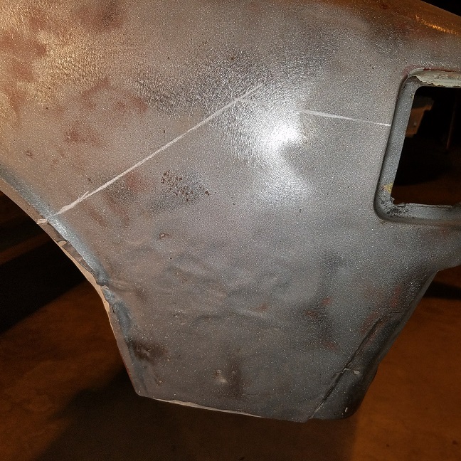

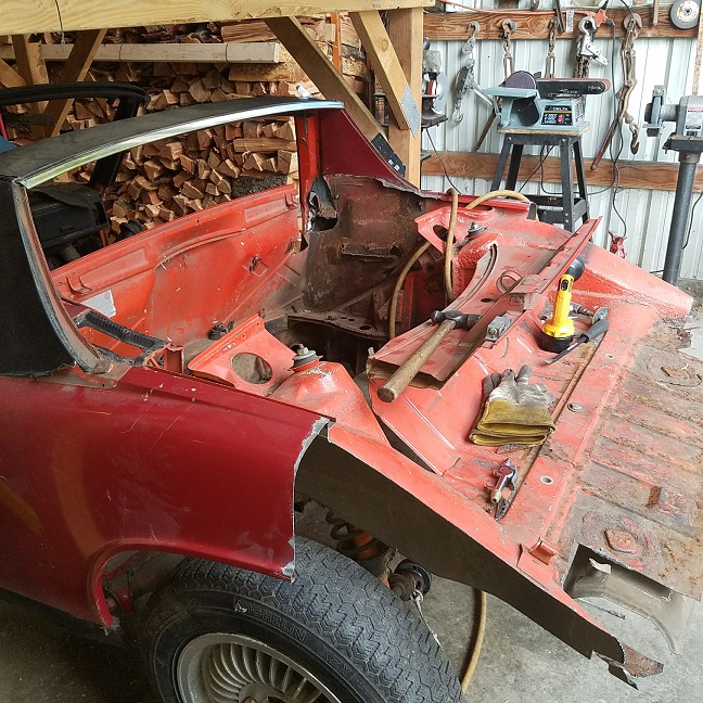

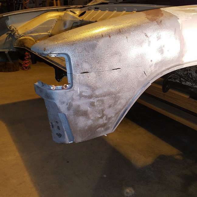

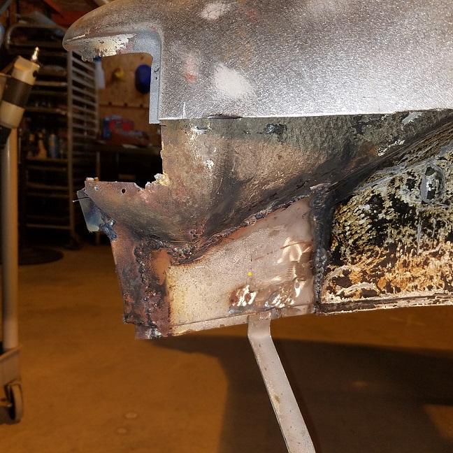

Ran to Clackamas first thing and picked up the new Snap-On air saw. By the time we stopped for lunch we didn't get to the shop till noon, but I hit the ground running.
I've been dreaming of cutting off the tail end of the qtr. panels for a month.
After the trouble with the trunk seal channels on Mark's car, I scaled back my cut out a bit. In addition both trunks are getting fiberglass with wood frame lids. Which will be quite the challenge to get the fit I want.
Back to cutting up a perfectly good car.

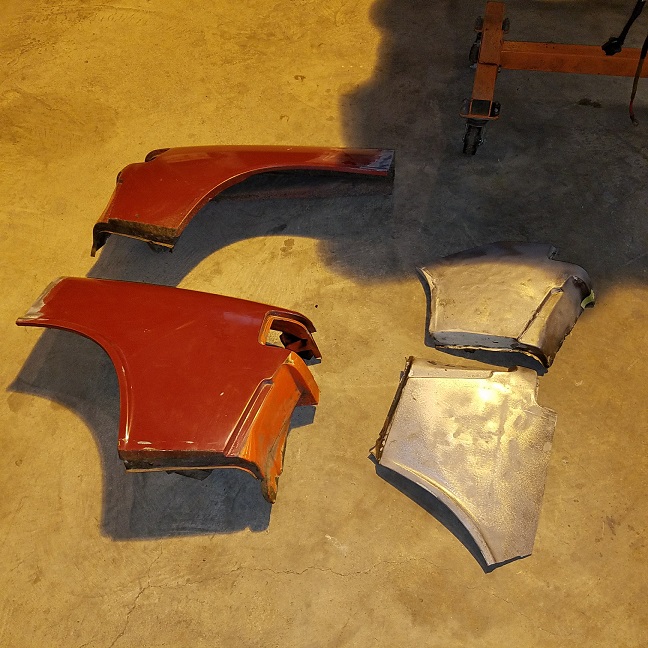

I got so engrossed in my work I forgot to shoot a couple before pictures of the parts car. (IMG:style_emoticons/default/sad.gif)

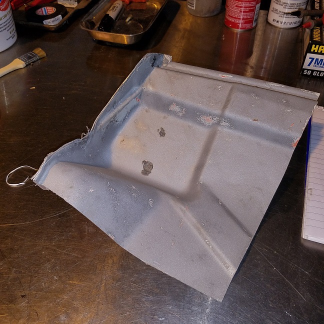

Qtrs cut off. Taillight panel cut away. Because of my needs on the qtr. panels I only salvaged the center section of the taillight panel. Super In Law is working on breaking down the tow hook in case it might be needed for a bumper back date.
Looks almost like the Pre-Runner truck I'll be driving in Baja. (IMG:style_emoticons/default/biggrin.gif)

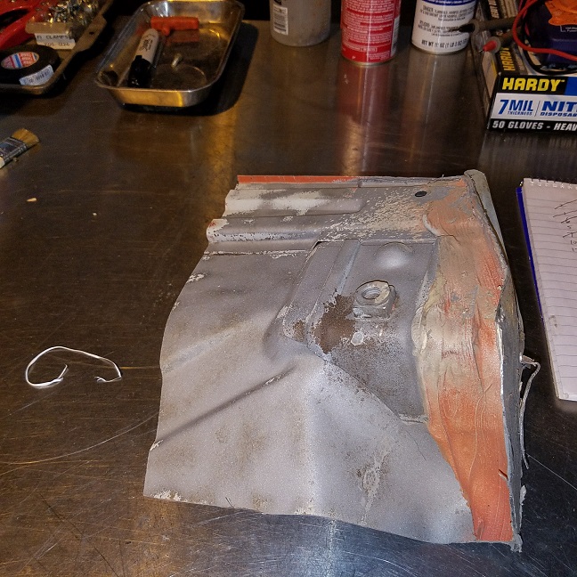

Then on to the tedious task of cutting out the seat belt retractor pocket.
This is not for the faint of heat. Very tight work up against the door/targa bar frame.

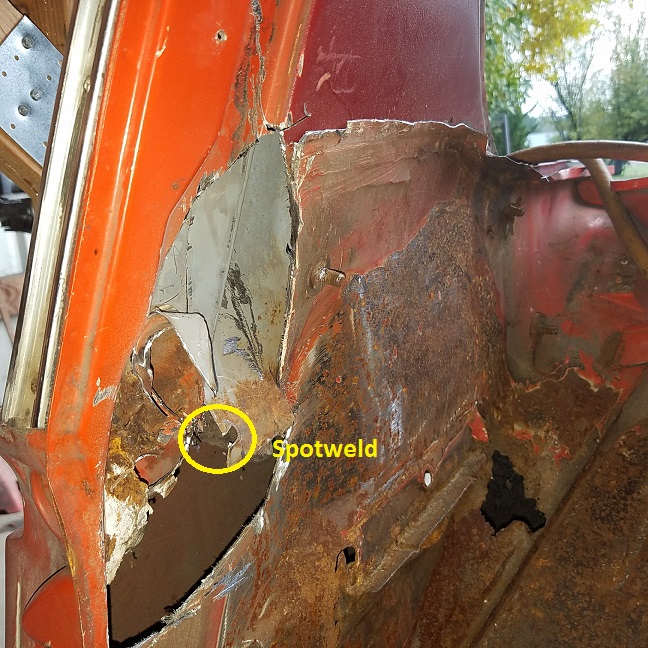

Primary issue is doing as little damage as possible to the parent material of the pocket area.
We will save/cut out the bottom half of the firewall at a later date
That one unseen spot weld gave me fits getting the piece out.
But here she is stripped down and sitting on the work table.
I'll get after the left side first thing in the am. Then on to the tedious task of unpeeling the onion. Breaking down the multi layered portion, one layer at a time.
