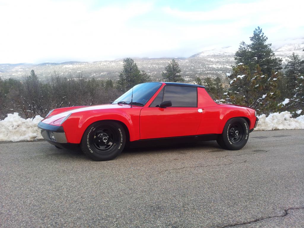

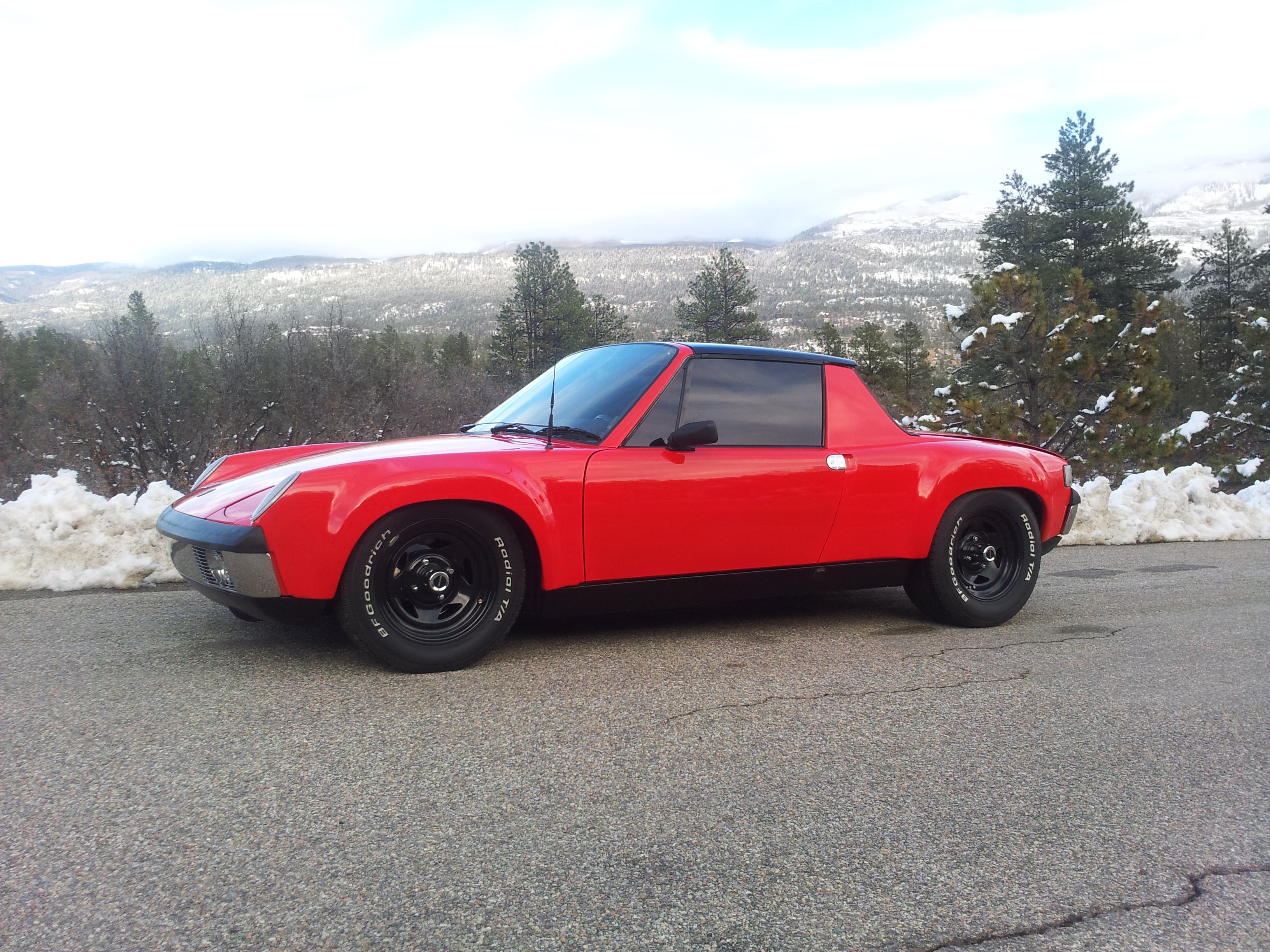

So you are going 7" and 8" and keeping it 4 lug? I have done it with Cragar 365s. I now have 5 lug wheels on the flared car.

Yes, that's the plan. Do you recall the offsets you ran? Did you run spacers? If so what size were the spacers

I have Hankook Ventus 2 tires on the car now. Good tires - but I haven't really pushed them to see how grippy they are. I know AZ914 is running the same tires on his 3.2L 914 and he might have a better idea.

Unfortunately I will never have an apples to apples comparison. When I went to 5 lug Fuchs I changed my rear shock/spring package at the same time so everything is different. I also went to a 16" wheel so I could have more tire options in the future. I also went wider tires front and rear. and went from a 60 series tire to a 50 series tire (it kept my speedometer spot on). So many changes that it is difficult to tell. I don't think I would consider the BFG a performance tire. The Hankooks maybe a little better. They are a directional tire with a more aggressive tread pattern.
When I bought the car it had the tire mounted with the raised white letters facing out. I think I would have gone black letters as well. The 914 guys at Route 66 Classic nicknamed them NASCAR tires! (IMG:style_emoticons/default/biggrin.gif)
