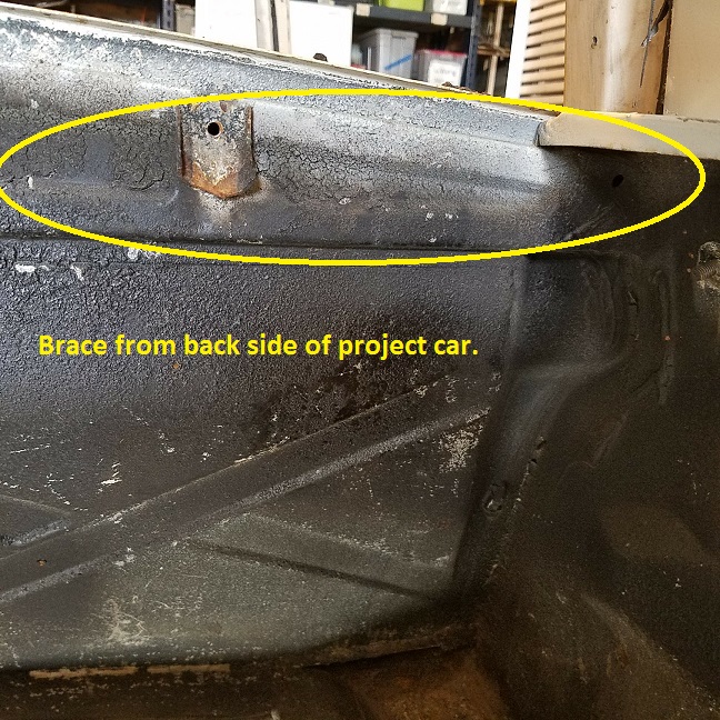

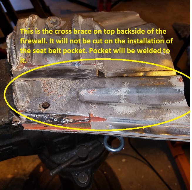

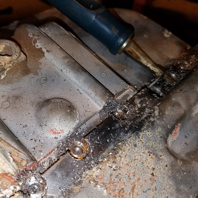

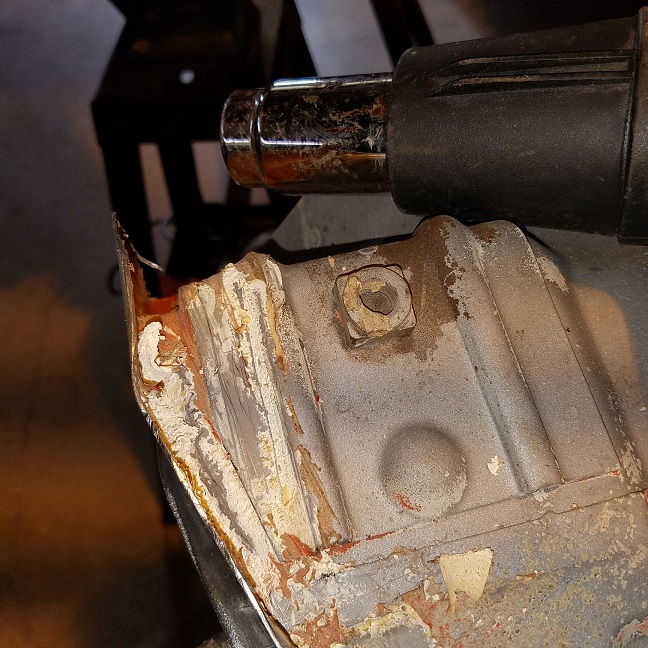

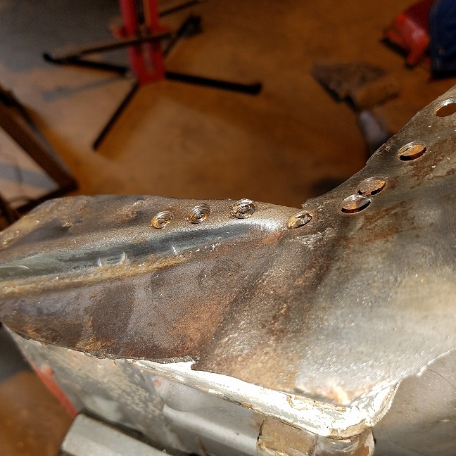

Friday was spent prepping the parts cut out of the donor car. Note : The parts were cut out intentionally large to allow me to work from the backside. This will allow me to do the least amount of damage to the parent material of the part being used on the car.
Step One :
Remove all seam sealer with heat gun and small and medium wood chisel.
Step Two :
Cut down back side of spot welds with cutter.
Step Three :
Pop off cut spot welds with small wood chisel
Engineering Plan :
After all the dust has cleared from the sawing. Determined that the pocket will be trimmed to fit. 1. Top portion will lay on the cross brace and be rosette welded in. 2. If I can, the outer and bottom weld to be lap welded with rosette and seam welds. Most of the busy work will be under the interior back pad.
