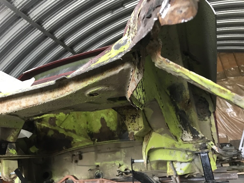

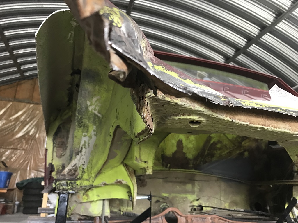

Here's a view of the underside where you can see, sort of, how the distance from the underside of the trunk floor to the bottom of the tail section is quite different from side to side (it's more obvious in real life):
Here's the view from the underside of the dirver's side:
Here's the view from the underside of the passenger's side:
I'm hoping the latter two pics might give some clues as to which side is (more) off.

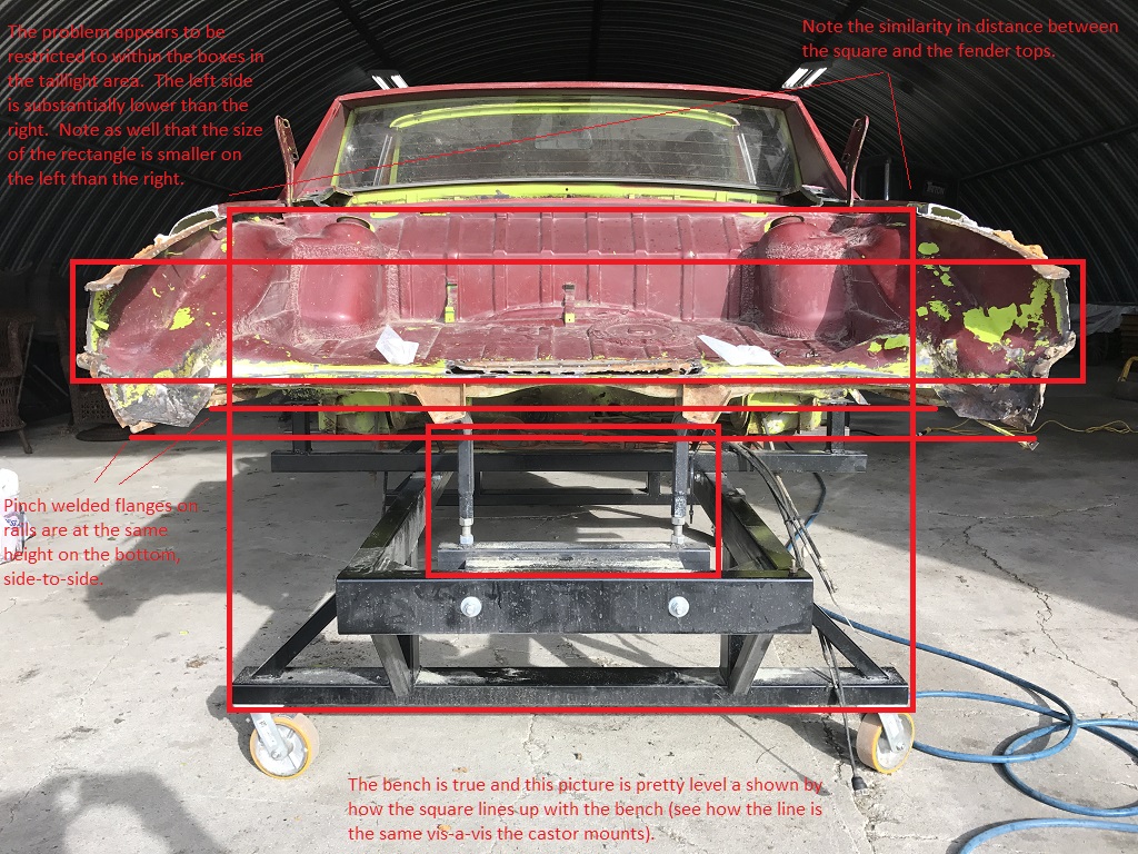

Yesterday I spent the day at the farm removing the rear quarters and tail section as per Jeff's advice. I'm still puzzled as to whether the left side is low, or the right side is high, or both. Here are the data:
The bench is true, so I've added rectangles relative to the bench to show where the car is out of whack. As shown in the pic below, the only place where it is out is at the last foot of the inner fenders. Either the left side is pushed down or the right side is pushed up. But this does not extend very far into the chassis. The pinch welds on the bottom of the rails are the same height from the bench side-to-side.

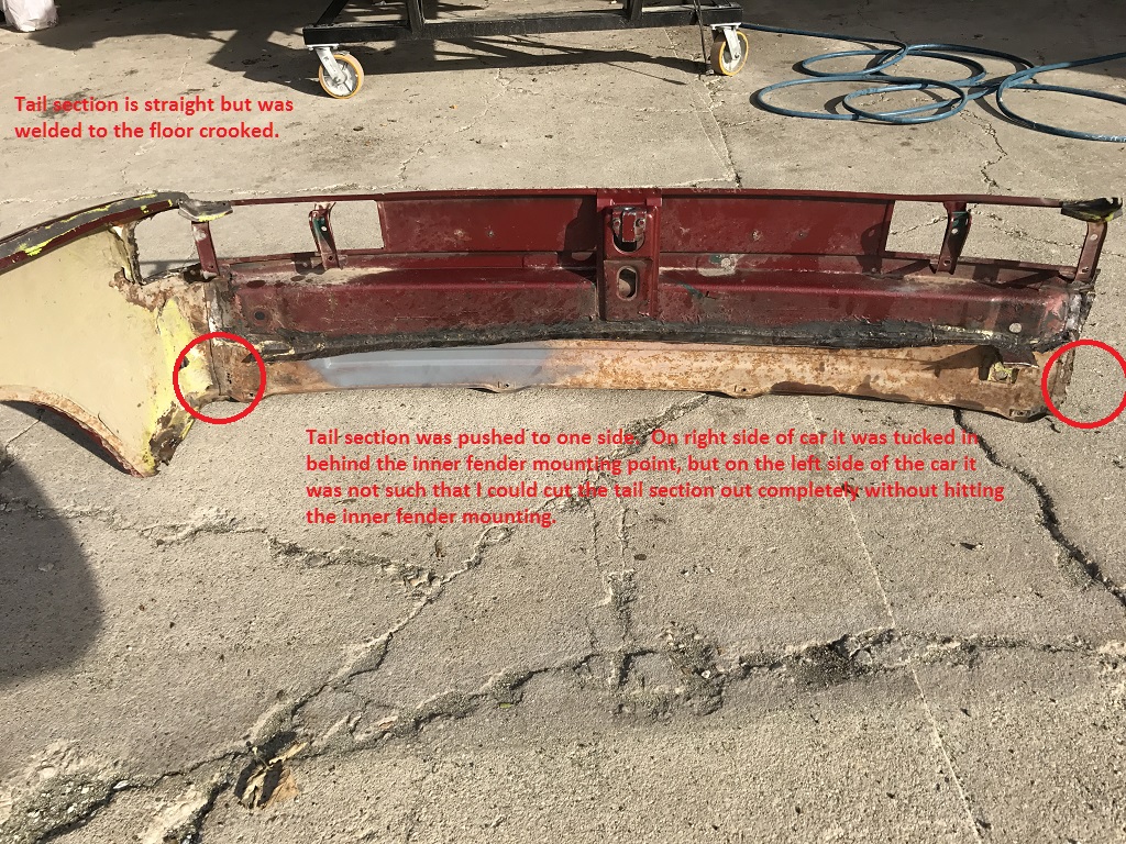

The tail was welded in crooked due to the difference in height side to side. It was also not equa-distant in its placement side to side. On the left side it appeared to be but welded to the fender and was to the right of the inner fender, so I was able to simply cut vertically to free the fender from it without damaging the tail panel. This could suggest that the left quarter is pushed out but I think the trunk opening was only 1cm narrow at the back. I supposed it could also be that the right quarter is pushed put as well.

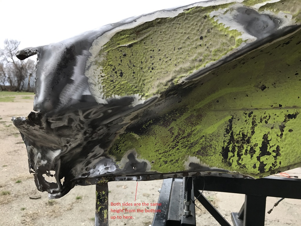

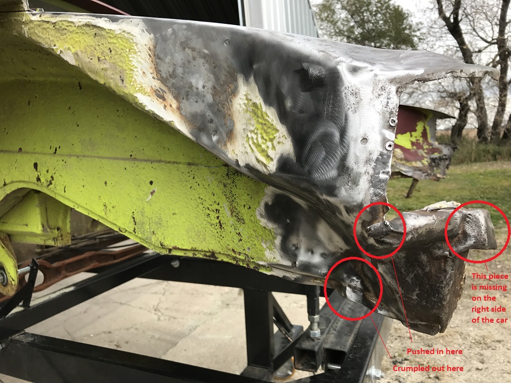

The right inner quarter seems less damaged than the left, though there is a piece missing from it (when compared to the left side; not referring to the gaping rust holes but rather the pice where the tail section welds to just below the taillight area). Again, the point indicated in the pic below is the same height from the bench on both sides.
The left inner fender has more damage. It is pushed in and there is a bigger bulge in the pinch weld compared to the right side.
Aside from the damage, the overall shape of the rails/pinch weld areas looks similar side-to-side.
So, with that background, the question becomes, how do I figure out what needs to be adjusted? Should I mock up with new quarters as well as new trunk lid, and the tail section and just move stuff until it all fits straight?
