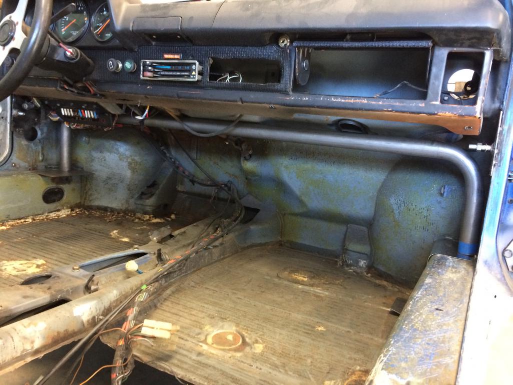

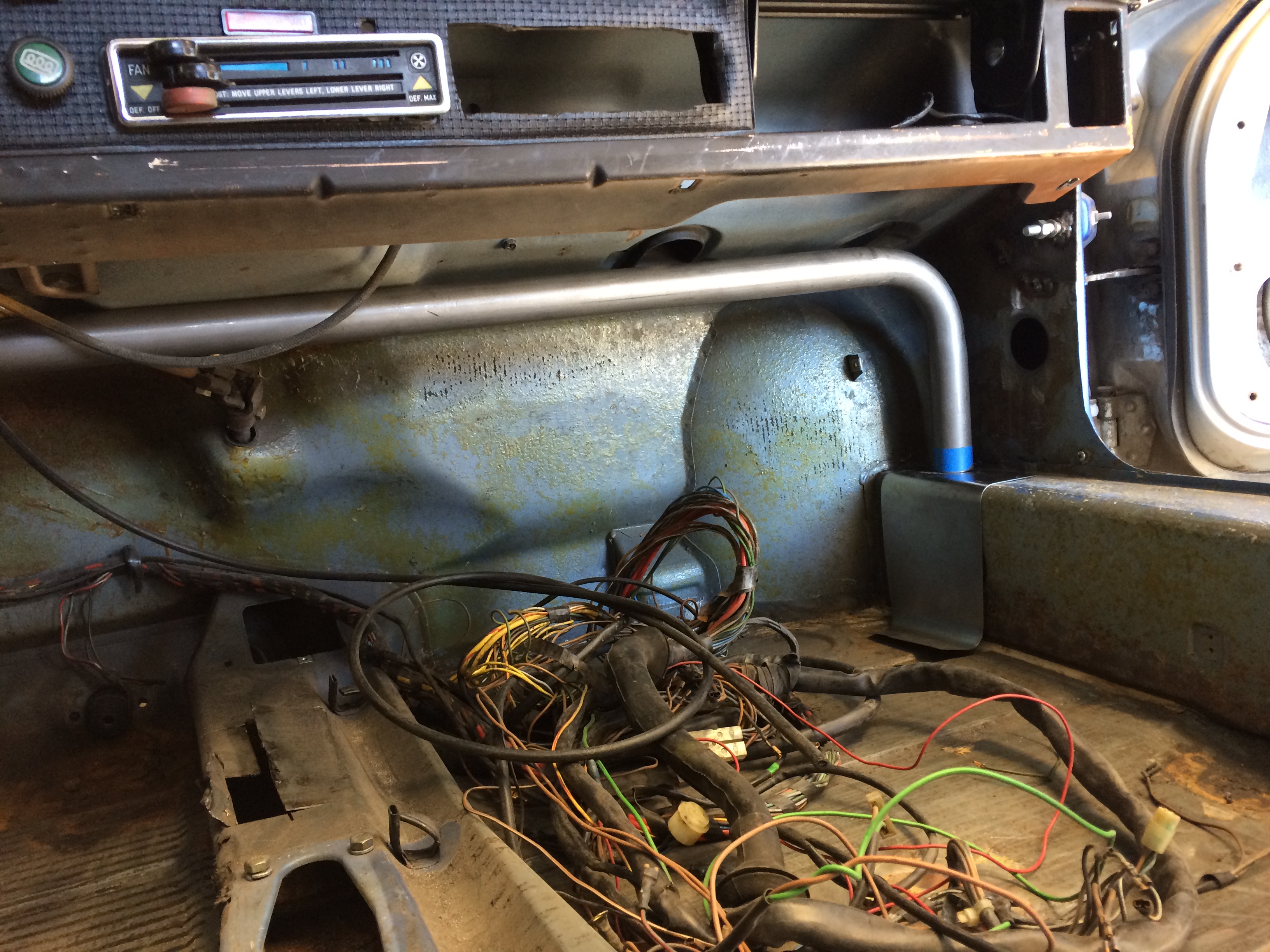

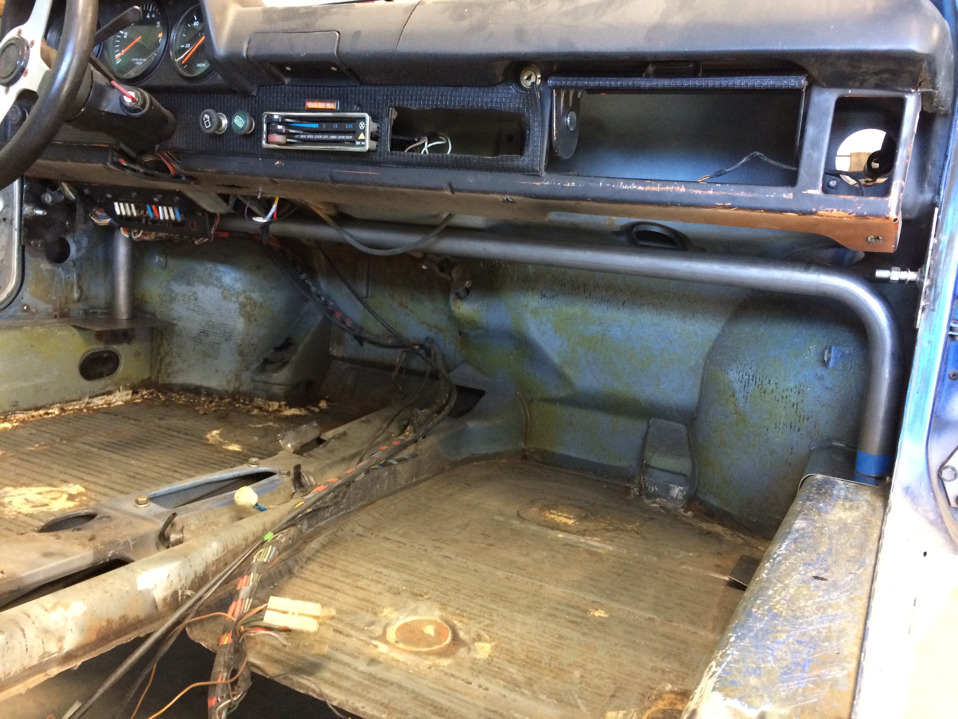

CHASSIS STIFFENING: Front Hoop/Door Bars
In keeping with the "hide as much as I can" approach, I bent up my front hoop (if something 9" tall qualifies!) and started trial fitting.
No, that isn't the real footing. It's just blocking the heater hole...
Initial fitment suggests I have plenty of foot clearance, can remove/install the steering shaft and even run the stock fuse panel, if I wanted (I don't).
It lines up nicely for a bar that will run from the hoop corner, through the heater hose hole and tie into the front shock tower.
