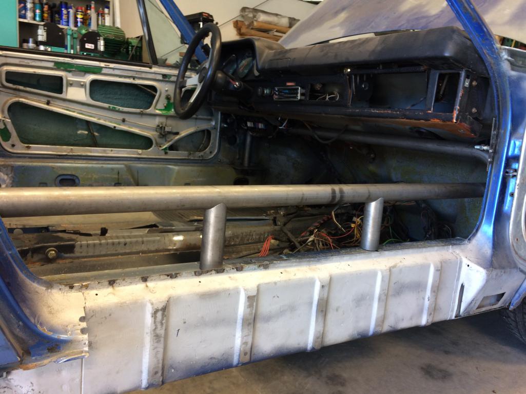

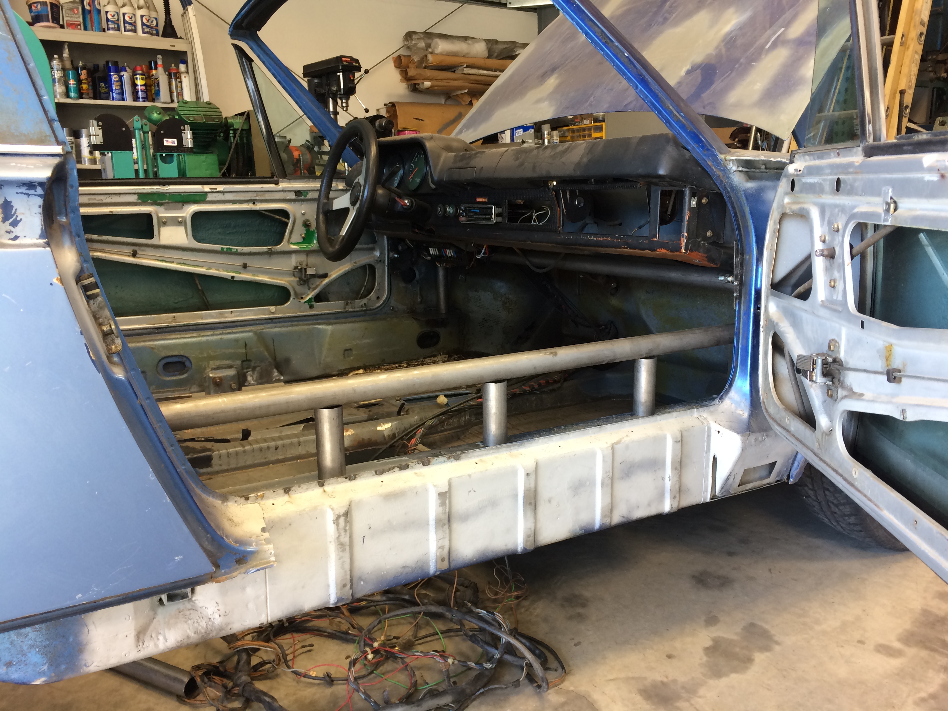

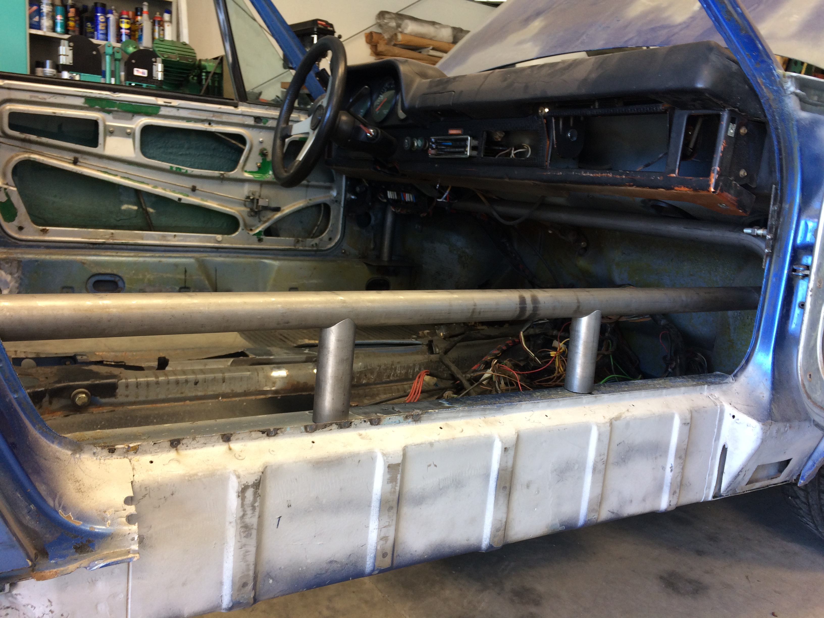

Next, I started on the door bar. I haven't landed on the final height. Taller = stiffer, but again, I want it to be as easy as possible to get in and out.
Comprise is the order of the day on this design.
The pics show an overall height of 5" to the top of the bar. At this point, I think that's as high as I'd want to go.
I'm not final on the design in terms of the drops to the long. It'll be two or three, I'm just not sure. Here's a pic of each. (Note that I hadn't yet coped the drop supports in that 2nd pic.)
One of my race car fab buddies is coming over later to take a look and make recommendations.

Rand   I don't think you need three verts. My choice ...   Oct 23 2016, 02:00 PM
Cracker   Chris - You don't need to have your bar that h...   Oct 23 2016, 03:39 PM
tygaboy   Chris - You don't need to have your bar that ...   Oct 23 2016, 05:26 PM
