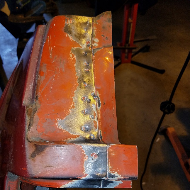

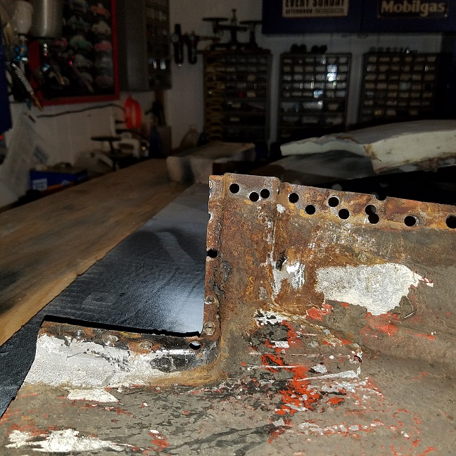

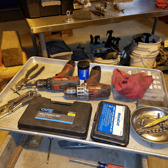

Now where was I ? Next I was on to preparing the qtr. panel back corners. After looking at the taillight panel I decided a was going open up the rosette holes on the lower portion. The lower portion of the taillight panel is solid. (IMG:style_emoticons/default/smile.gif)
The cut out of the taillight portion went well. Did have one drill thru, but all in all, nice. You will find piles of seam sealer up in the inside corner. (IMG:style_emoticons/default/mad.gif)
Next will be blasting it clean. I'll use garnet on the back. I'm thinking I'll try the walnuts I have for the front. See what type of finish it gives me.
Weapons tray ..............

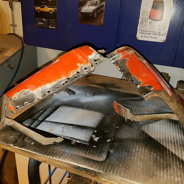

cary   I decide its time to start using the plasma cutter...   Jul 7 2016, 09:17 PM
cary   Then on to removing the exhaust shield from the ol...   Jul 7 2016, 09:41 PM
cary   We did extract the other hole plug. Have the templ...   Jul 7 2016, 10:09 PM

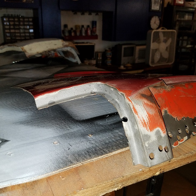

cary   Start the day with trimming the trunk panel. Not a...   Jul 15 2016, 08:33 AM
cary   Feel asleep while writing the post. Early start an...   Jul 15 2016, 09:06 AM
cary   Here's a shot of the buggered up tail light pa...   Jul 15 2016, 11:23 PM

cary   Here is the left inside trunk corner cut out from ...   Jul 24 2016, 06:29 PM
cary   As I was working on the inside of the trunk. Super...   Jul 24 2016, 06:37 PM

cary   Friday was spent prepping the parts cut out of the...   Oct 22 2016, 12:08 PM
cary   Now where was I ? Next I was on to preparing the ...   Oct 23 2016, 02:35 PM
