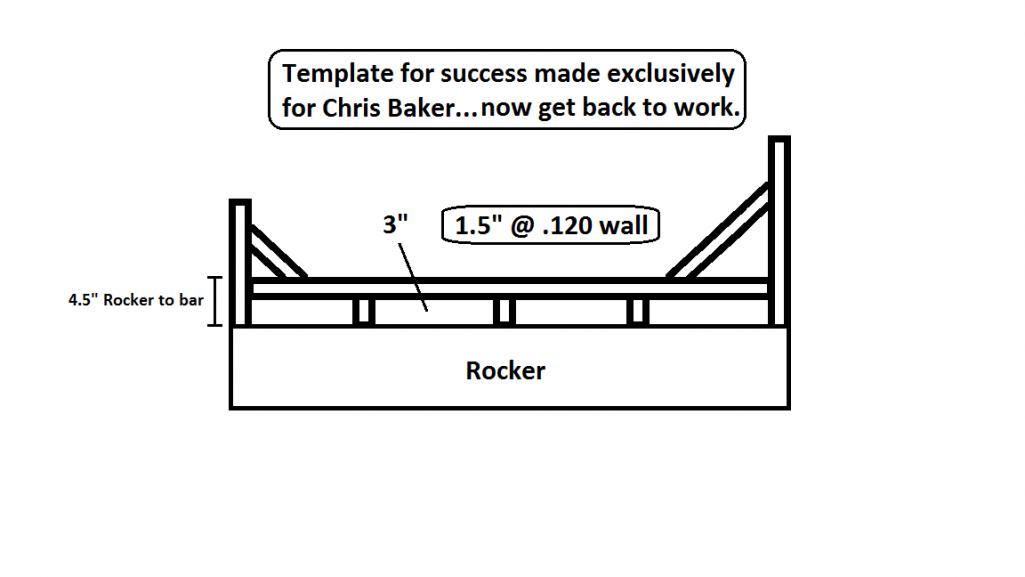

Chris - You don't need to have your bar that high - consider what I designed for you below (and if followed) - never look back.
The center support is important and I would not eliminate it from the design. The gussets at each end upright are absolutely necessary and should be implemented. Call me if you need to discuss.
I too will be re-configuring my cage in the next year or so - converting it to a more "hot rod" style like your car. I won't go any higher than the 4.5" (and probably even lower) from top of rocker to top of bar I've illustrated below when I do it (JMO).
Keep up the good work.
Tony

Rand   I don't think you need three verts. My choice ...   Oct 23 2016, 02:00 PM
Cracker   Chris - You don't need to have your bar that h...   Oct 23 2016, 03:39 PM
tygaboy   Chris - You don't need to have your bar that ...   Oct 23 2016, 05:26 PM
