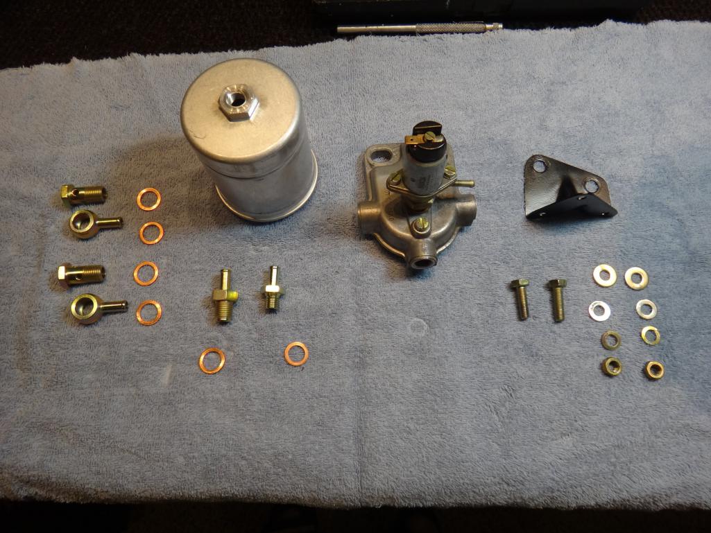

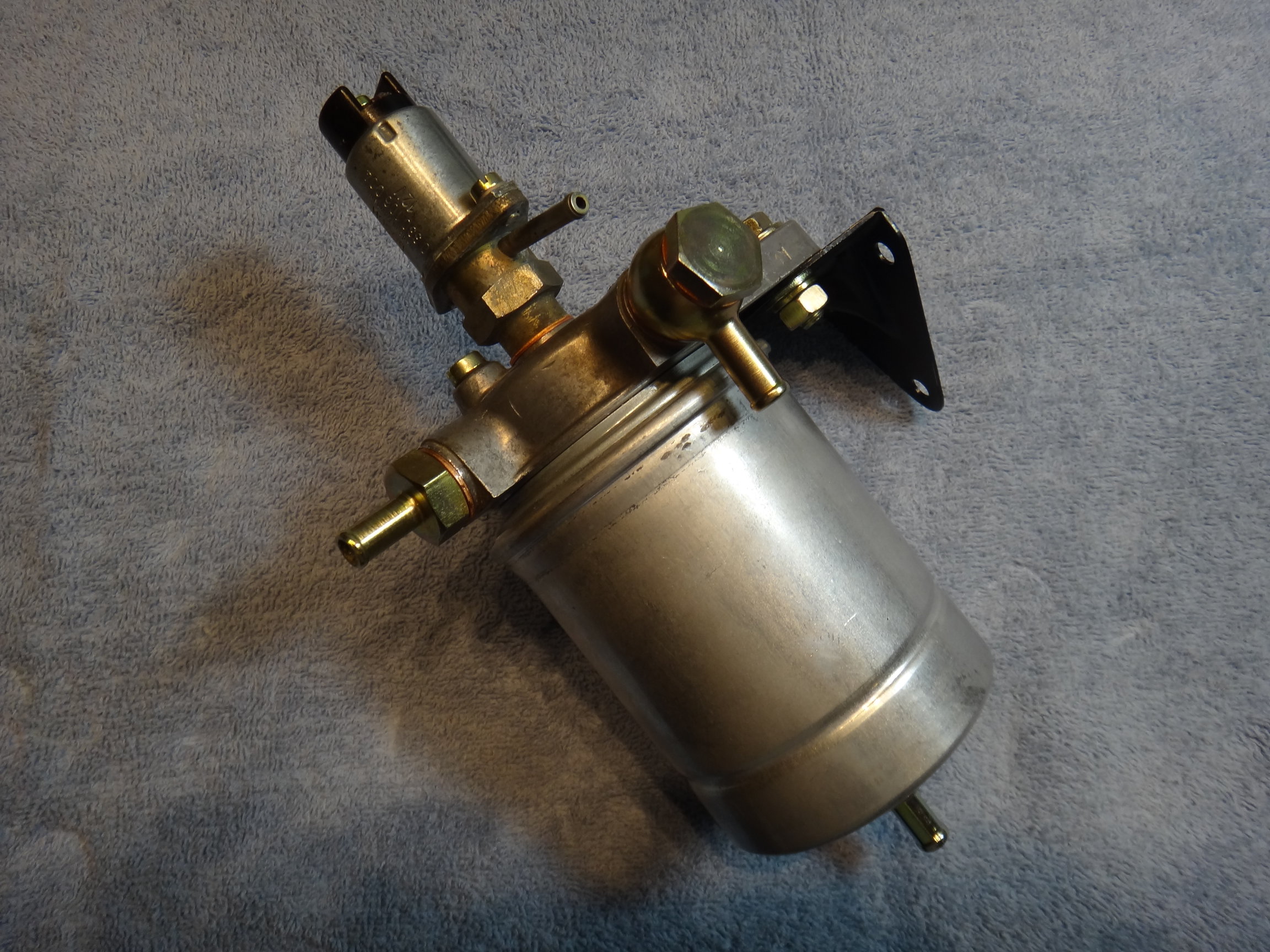

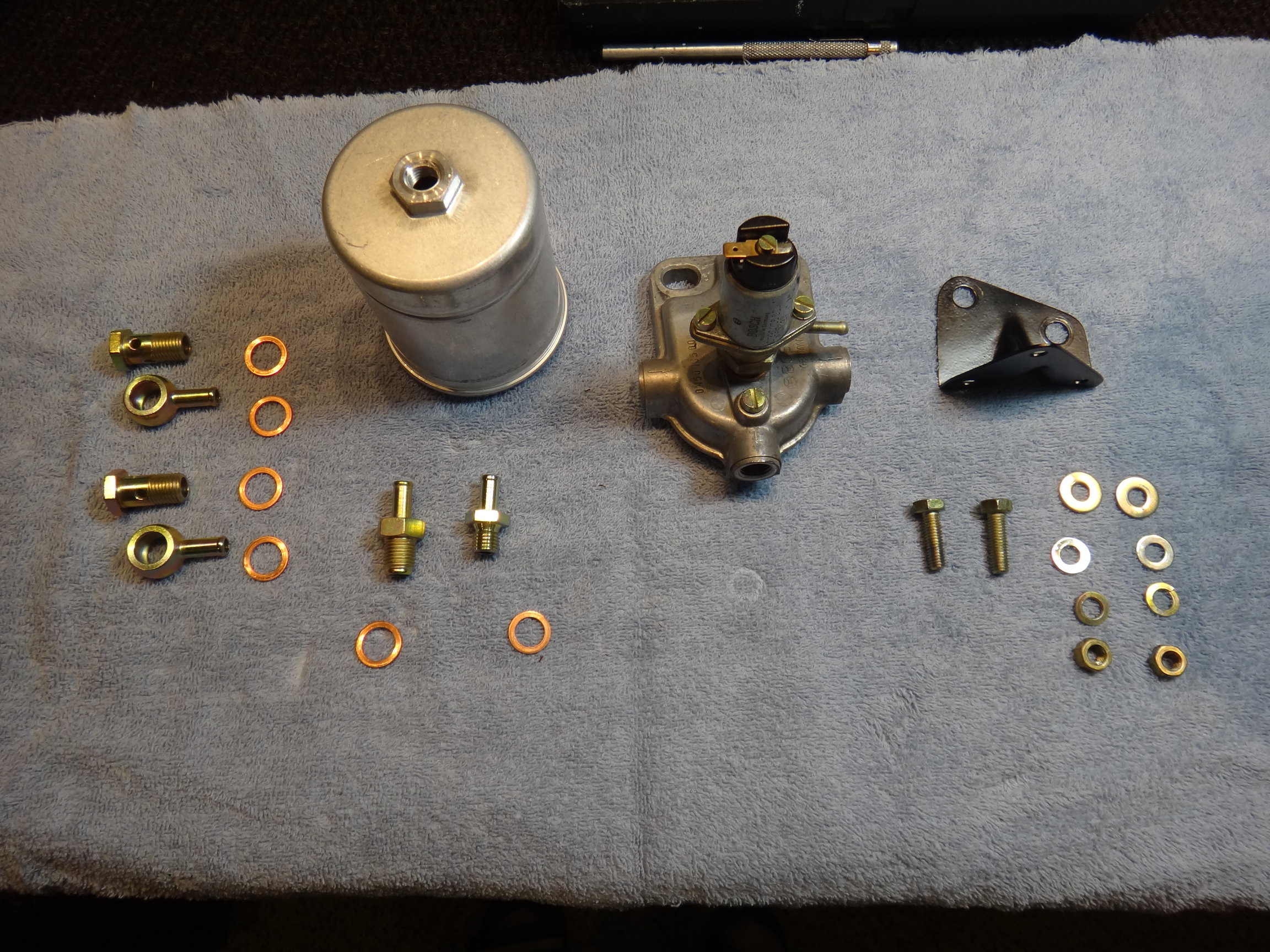

Because I'm putting a 2.4 MFI engine into the car, certain MFI specific items are needed.
First off, MFI micro filter and console.
New filter, powder coated bracket, freshly yellow zinc plated hardware, new seal gaskets, and misc hardware.
Ready to supply high pressure fuel to the hungry beast....
