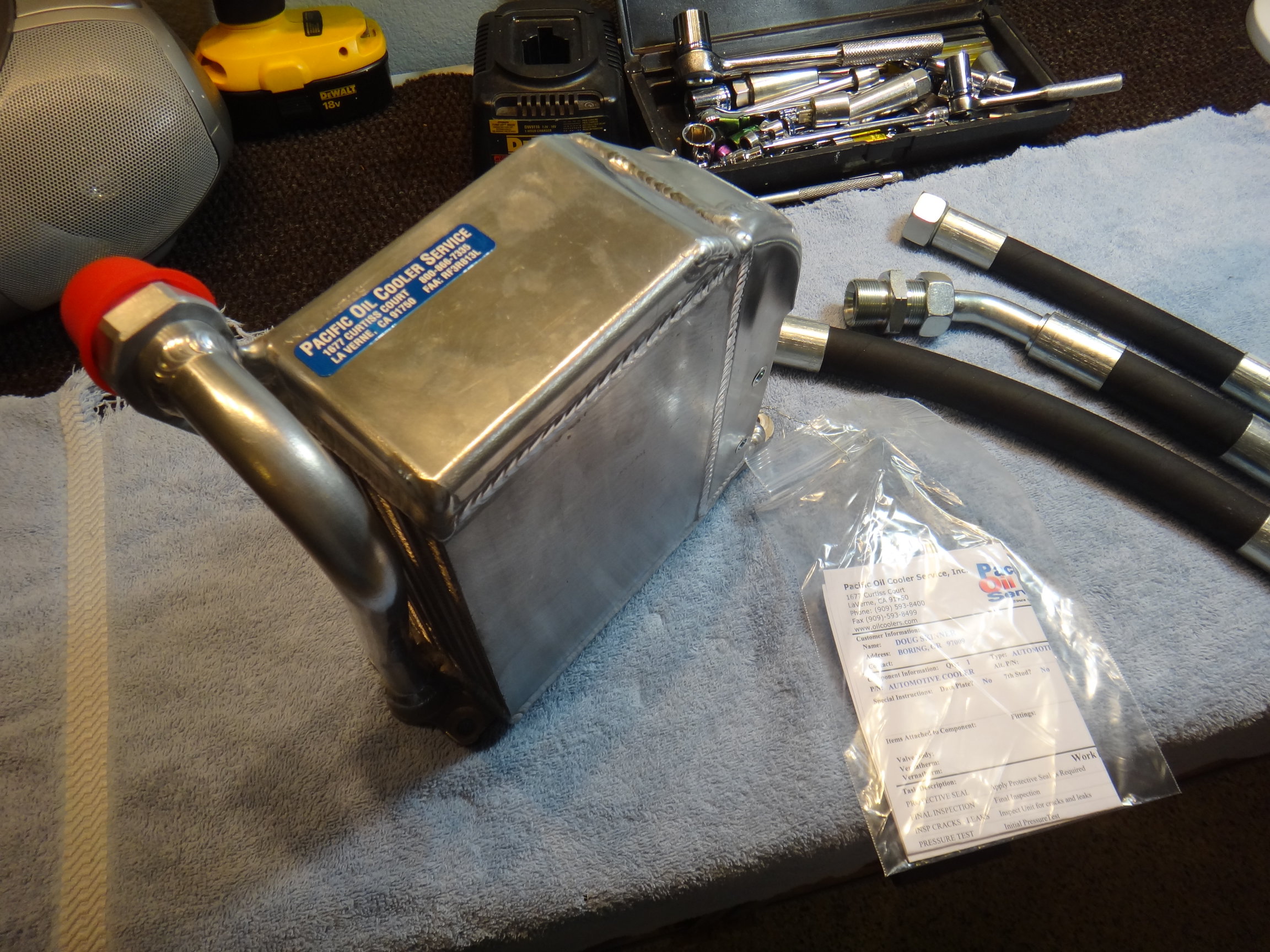

From Stoddards, a new high efficiency 914-6 oil cooler.
This was sent to Pacific Oil Cooler to be cleaned and pressure tested.
Considering what the engine will cost to build, this seemed like a smart thing to do.
It's hard to tell by just looking whether or not these oil coolers are good...
For example, the oil cooler that came on the engine actually failed the pressure test even though it looked fine....was going to sell it. Trashed it instead.
Also most of the flexible oil lines that go with the 914-6 oil tank....
