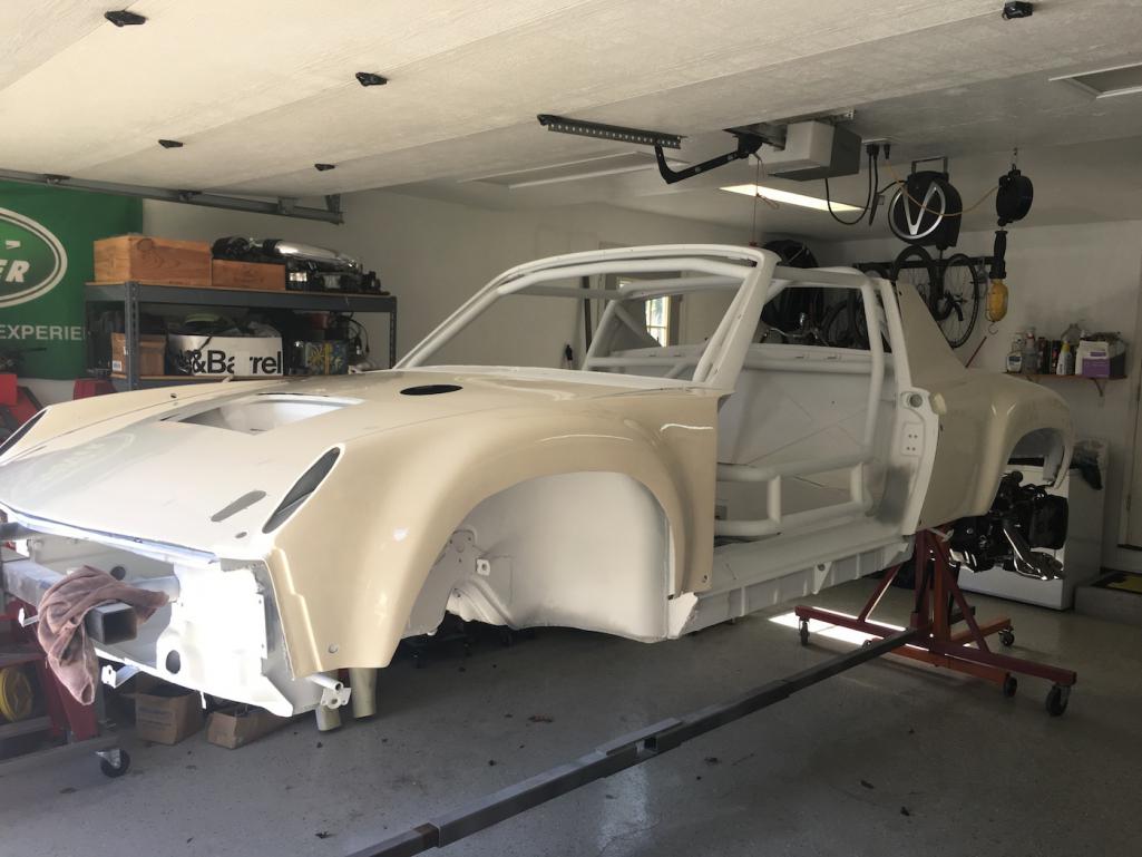

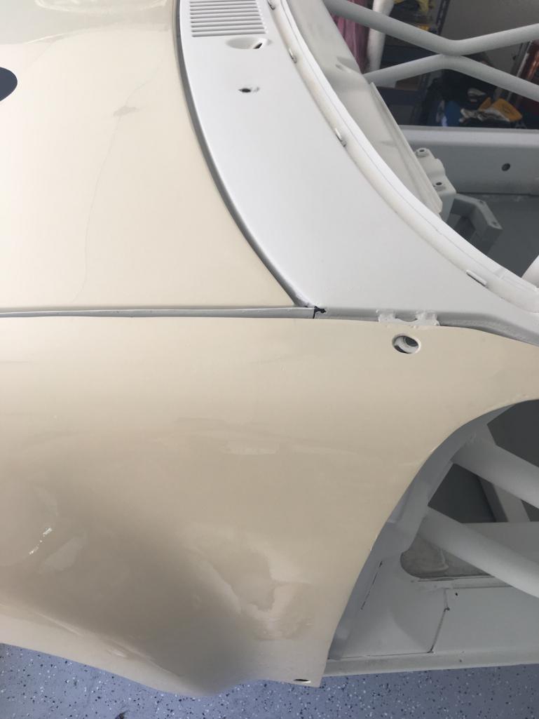

Sometimes you just have to say "screw it", put on your big-boy pants, and get down to work.
I've been toying with the idea of painting the car myself and this past Saturday I got down to business and started spraying. Yes, I used a cheap HF gun (I've got a new Eastwood gun on order). Yes, the panels did not come out as perfect as they would if I had paid someone.
Do I care? Well, yes and no. I figure, this is my project, for better or worse, and the only way Im going to learn is by making mistakes. Im precise all week long for my job, on the weekends I think Im entitled to a bit of /experimentation/ (IMG:style_emoticons/default/smile.gif) I've been using this HF gun for a few years now so Im not totally new to painting with it. The fenders all turned out great actually, while the hood has some pitting that Im not too happy about, but the white paint does a lot to hide the flaws.
The color is Wimbledon White, its kinda creamy. Its the same paint we used on my brothers 912-STi project. The bumpers, rockers, roof, and sail panels will be finished in satin black.
