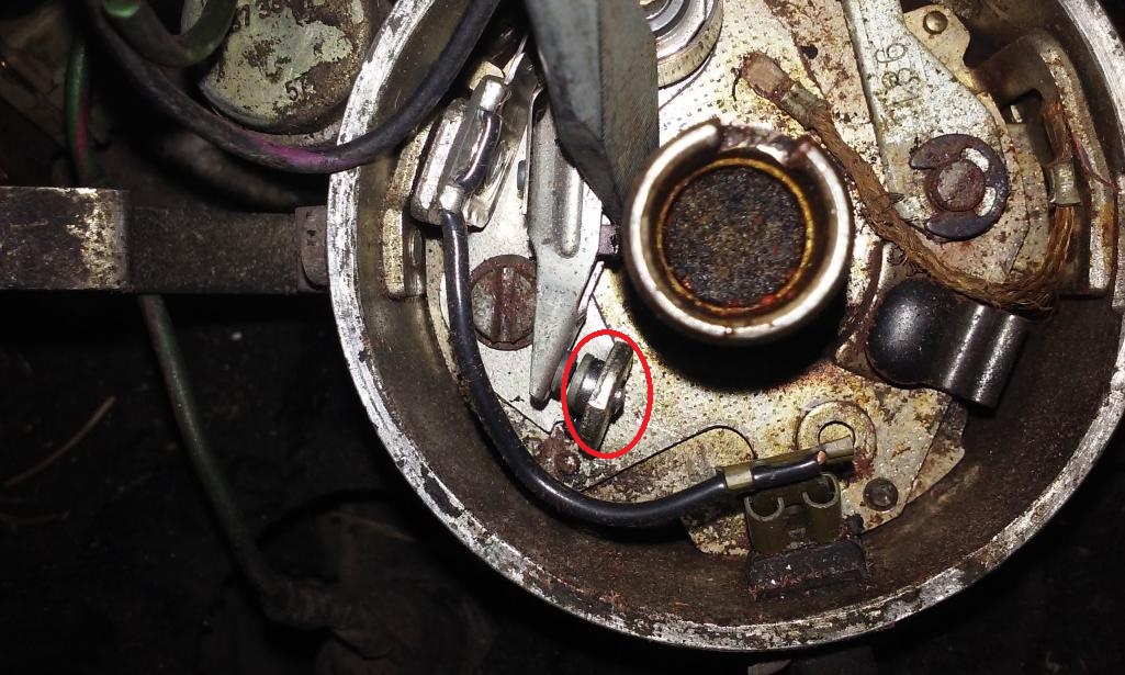

After checking the ground strap, take your voltmeter and check the resistance between the negative battery post and the thing I have circled in red, you should have 0 ohms

QUOTE(timothy_nd28 @ Oct 24 2016, 08:55 PM) *
The ground strap from tranny to car looks good. Quite clean. There is also an extra ground cable from the negative battery terminal to the transmission.
The volt meter at the points think circled in red reads 0 ohms.
