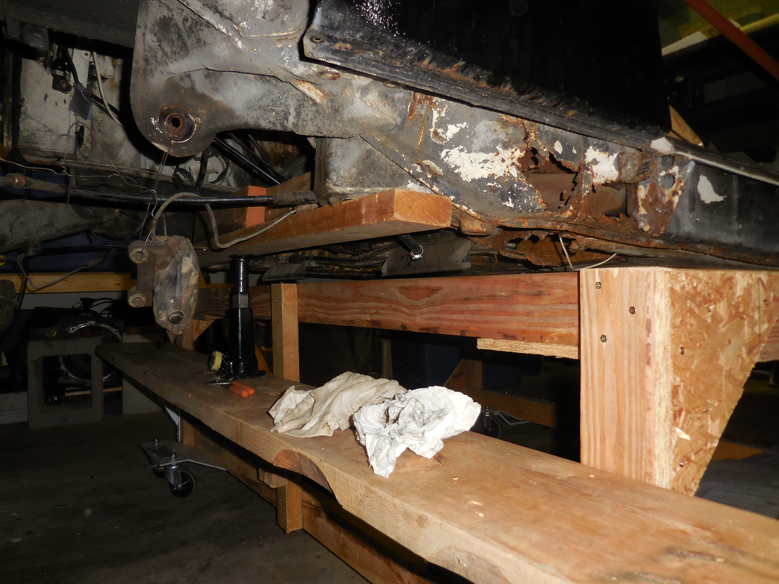

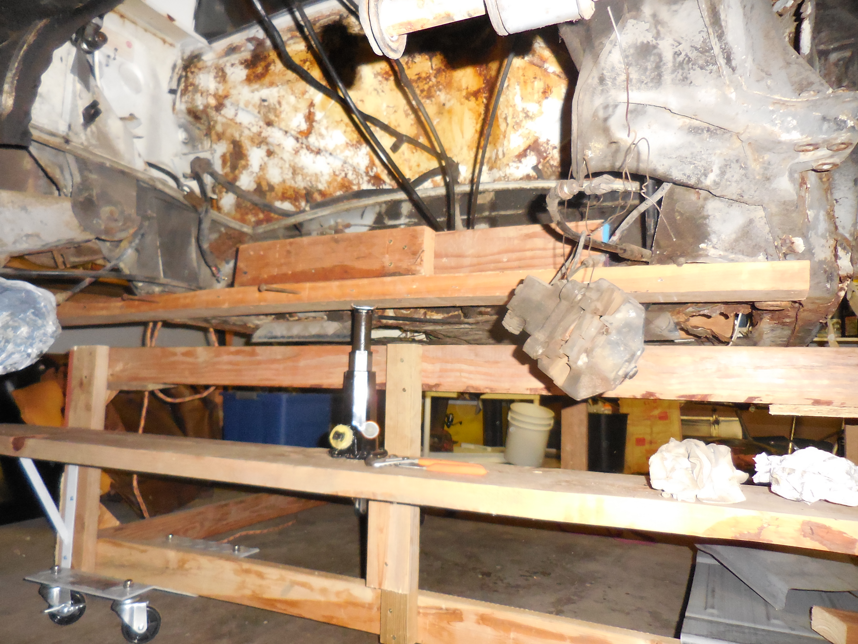

I installed the bracket that will host the jack to lift the car above the square of the stand so that i can cut and weld away panels. Here are some photos.
