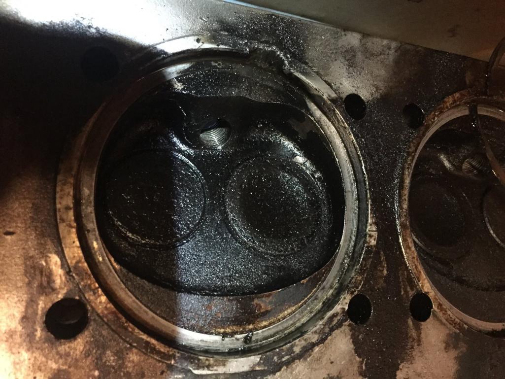

Picture "borrowed" from brand new post on the 914 Facebook page.
Gasket failure,

Mueller   Head gaskets installed on my current torn apart mo...   Oct 26 2016, 09:55 AM
injunmort   i could be wrong but what i see is a deformed gask...   Oct 26 2016, 10:09 AM
HAM Inc   i could be wrong but what i see is a deformed gas...   Oct 26 2016, 11:20 AM
Mueller   i could be wrong but what i see is a deformed gas...   Oct 26 2016, 03:45 PM

Mueller   Picture "borrowed" from brand new post o...   Oct 27 2016, 09:36 AM
Dave_Darling   Picture "borrowed" from brand new post ...   Oct 27 2016, 05:15 PM
