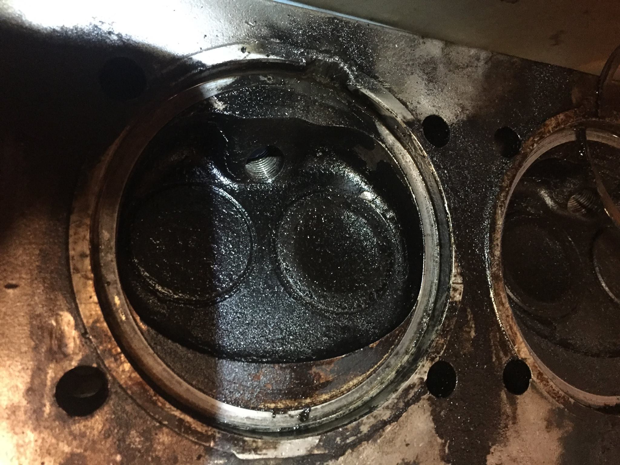

Picture "borrowed" from brand new post on the 914 Facebook page.
Gasket failure,
Dave_Darling
post Oct 27 2016, 05:15 PM
914 Idiot
Posts: 15,335
Joined: 9-January 03
Member No.: 121
QUOTE(Mueller @ Oct 27 2016, 08:36 AM) *
Gasket failure,
Yup, that is the absolutely typical gasket failure. As in, if/when the gasket fails, that is what happens. If you let it go even longer (just turn up the radio!) that eroded area turns into a deep channel.
I don't know if the head in the photo is junk yet or not, but if it were allowed to get much worse it definitely would be.
--DD
