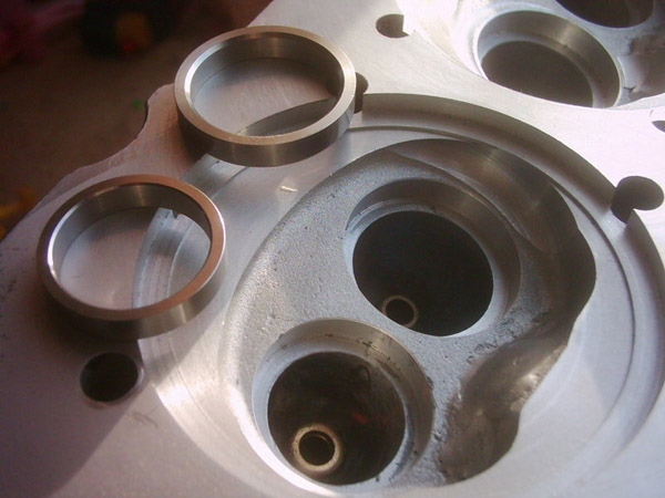

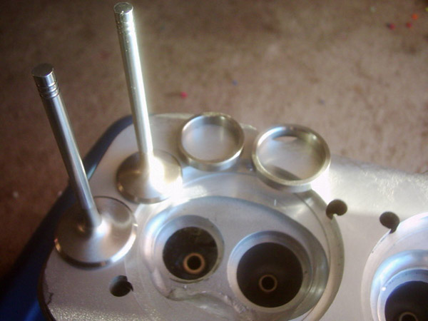

Mark Henry   Some head work I posted way back when this site st...   Oct 28 2016, 01:23 AM

N_Jay   The problem with those heads pictured was not that...   Oct 28 2016, 07:24 AM
