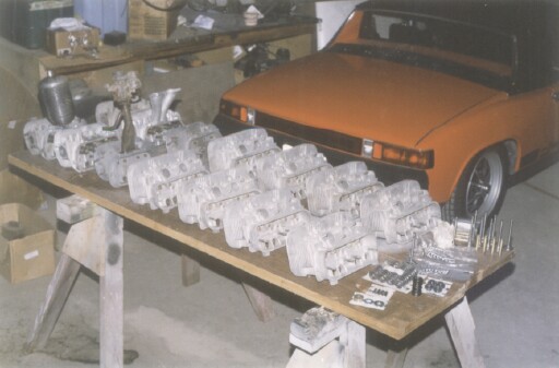

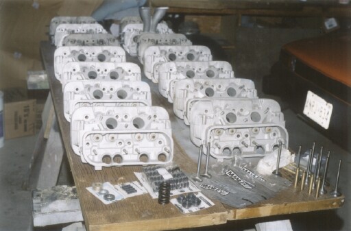

Some head work I posted way back when this site started.
(IMG:http://www.914world.com/bbs2/uploads/post-2-1051929643.jpg)
(IMG:http://www.914world.com/bbs2/uploads/post-2-1051929861.jpg)
