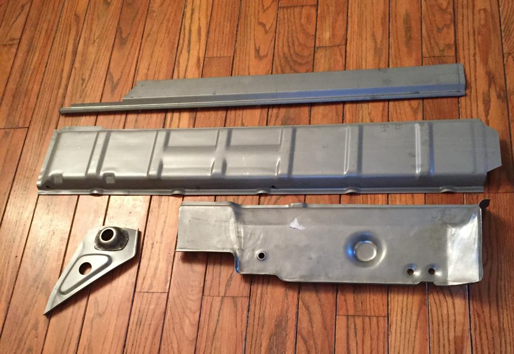

Fed ex truck dropped off some goods today.
Thanks to the guys at Restoration Design.
These parts are gonna make life a lot easier
in the coming months.
