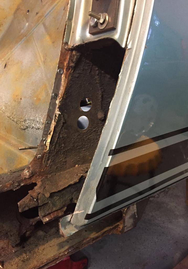

Well I've started the process of preparing for
my 2056 GT to 2.4L six "rallye tribute" auto.
Tearing into the interior I discovered some rust mites have been eating for a while.
Doesn't look too extensive but will be probing some more. The exterior left long was
patched a long time ago, albeit incorrectly. This was done by shop
that wasn't fully up to speed on these cars and I was still a novice, well
still am. I'll be doing some exploratory surgery on this left side inside and out. So I'll get this addressed before any engine install takes place. Would like to
have it buttoned up for Hershey 2017. Wish me luck.

Thanks Dean, the whole dash is out. Have a nice NOS to put in there.
I'll be covering more of it with thicker plastic when it's time for paint.
Cutting around the door brace on the jamb side till I can weld a triangular
plate near the floor and long and firewall then I'll remove the jamb.
Goal for tomorrow is removing all of rear left quarter panel. "Tyga" I'll check the donut thanks.
