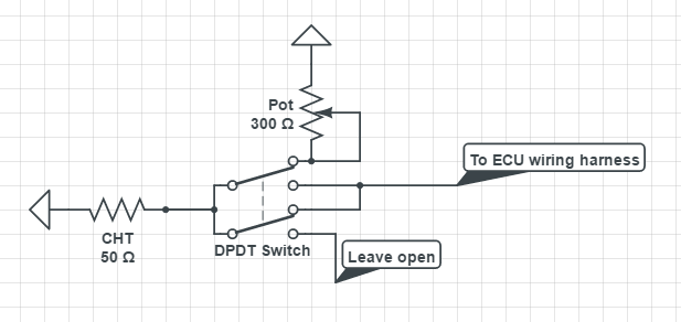

Here's the schematic for using a DPDT switch and a 300 ohm pot to create a circuit that would allow you to put parallel resistance to the CHT, and lower the resistance seen by the ECU, so that the ECU thinks the car is more warmed-up than the CHT is telling it. Flipping the switch to the other position takes the pot out of the circuit and lets the CHT alone control the ECU.
EDIT: might be better to use a 500 ohm pot, they're more readily available, cheaper, and smaller. The current requirements for this application are low.
500 ohm Pot
http://www.parts-express.com/500-ohm-poten...-shaft--023-500
DPDT switch
http://www.parts-express.com/dpdt-slide-sw...-lever--023-670
Probably the best way to implement this is to run wires from the CHT and the ECU wiring harness to the passenger compartment, then use a small project box to house the pot and the DPDT switch.
Note this is STRICTLY ThEORETICAL at this moment, nobody has done this to my knowledge and it may not work. Try at your own risk/gain.
