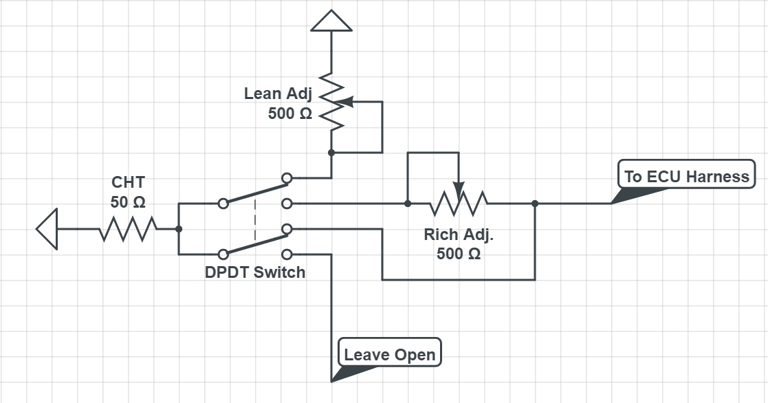

OK, here's a circuit version with two pots, one for lean adjust, one for rich. To have the CHT be in control and the pots out of the circuit, flip the DPDT switch to the other position and turn the "Rich" pot fully to the right (shunt) position.
