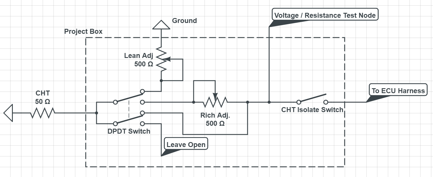

OK, I can't stop, here's one more circuit where I've added a test node and an isolation switch, so that you can test either the voltage across the CHT and series/parallel circuit, or by opening the switch, test the resistance to ground. Obviously, when the Isolate switch is opened, the car won't run because the ECU will see an open for the CHT, but you can test the resistance so that you know what the setpoint is. While the car is running, you can watch the voltage and see how it's changing as the temperature changes the resistance of the CHT or you change the adjustments on the pots and DPDT switch. Note I have the CHT at 50 ohms, that's just the approximate resistance of the CHT when the car is fully warmed-up.
SPST Switch
http://www.parts-express.com/spst-mini-pad...switch--060-532
Banana Binding Post (red, buy 2: ECU, Test Point)
http://www.parts-express.com/binding-post-red--090-485
Banana Binding Post (black, buy 2: CHT, ground)
http://www.parts-express.com/parts-express...-black--090-480
Banana Plug (red, buy 2: ECU, Test Point)
http://www.parts-express.com/parts-express...ug-red--090-465
Banana Plug (black, buy 2: CHT, ground)
http://www.parts-express.com/parts-express...-black--090-460
Project box
http://www.parts-express.com/hammond-1591a...97-083--320-702
Pot Knobs
https://smile.amazon.com/gp/product/B00NN6M...=UTF8&psc=1

pbanders   Here's the schematic for using a DPDT switch a...   Oct 28 2016, 06:02 PM
pbanders   I never was worth a crap as an EE, I was more of a...   Oct 28 2016, 06:06 PM
pbanders   OK, here's a circuit version with two pots, on...   Oct 28 2016, 06:35 PM
pbanders   OK, I can't stop, here's one more circuit ...   Oct 28 2016, 06:48 PM
Spoke   OK, I can't stop I know the feeling. Here...   Oct 28 2016, 08:37 PM
pbanders   [quote name='pbanders' post='2417044' date='Oct 2...   Oct 28 2016, 09:47 PM
pbanders   One thing I always know for sure: If I draw a circ...   Oct 28 2016, 09:52 PM
