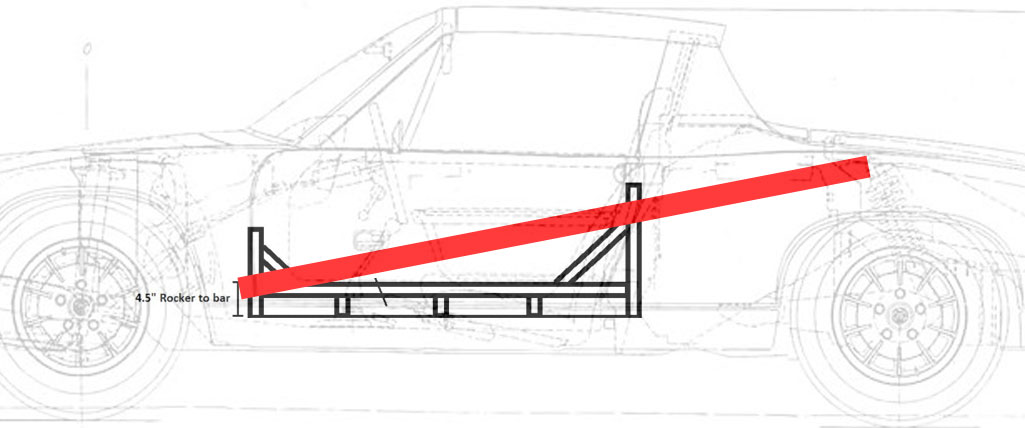

Chris - You don't need to have your bar that high - consider what I designed for you below (and if followed) - never look back.
The center support is important and I would not eliminate it from the design. The gussets at each end upright are absolutely necessary and should be implemented. Call me if you need to discuss.
I too will be re-configuring my cage in the next year or so - converting it to a more "hot rod" style like your car. I won't go any higher than the 4.5" (and probably even lower) from top of rocker to top of bar I've illustrated below when I do it (JMO).

QUOTE(Cracker @ Oct 23 2016, 02:39 PM) *
Curious what your thoughts are on simply running a tube from the rear shock tower straight to wherever is the best point in the front wheel well inside. One simple tube for maximum triangulation, no need for all the extra bits in the truss design.

QUOTE(Rand @ Oct 28 2016, 05:17 PM) *
I'm pretty sure that angle would make it tough to get in and out. If I remember, I'll mock that up and see how bad it might/might not be. Worth a look. Thanks for the idea!

QUOTE(tygaboy @ Oct 28 2016, 05:21 PM) *
Could be. But look at Sir Andy's car. His is easy to get in/out of. More swooped, but reality is, a bar like this doesn't interfere as much as you'd think. Sometimes it's actually easier to get in and out using the bar. And it triangulates the huge miss behind the firewall! That's an important part of this car, especially when you consider the worst rust weakening happens behind the firewall. Could also run an X tube to front suspension points.
Real cages and reinforcements have already been engineered. This is just brainstorming. But I figure this one red tube does more than all the black ones combined with less weight and effort?

QUOTE(Rand @ Oct 28 2016, 05:33 PM) *
Interesting... My initial reaction is that this seems worth a much closer look!
I do want to clear up your comment (bolded above) that what Tony's design (and mine) have that isn't shown in his drawing, are tubes that do triangulate from the roll hoop back to the suspension point. Not picking on your perspective at all, just want all facts known. (IMG:style_emoticons/default/smile.gif)
