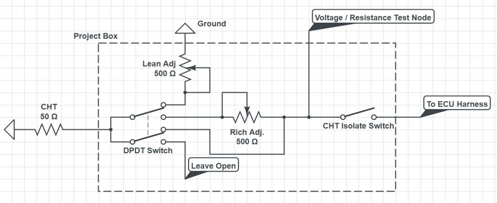

OK, I can't stop, here's one more circuit where I've added a test node and an isolation switch, so that you can test either the voltage across the CHT and series/parallel circuit, or by opening the switch, test the resistance to ground. Obviously, when the Isolate switch is opened, the car won't run because the ECU will see an open for the CHT, but you can test the resistance so that you know what the setpoint is. While the car is running, you can watch the voltage and see how it's changing as the temperature changes the resistance of the CHT or you change the adjustments on the pots and DPDT switch. Note I have the CHT at 50 ohms, that's just the approximate resistance of the CHT when the car is fully warmed-up.
SPST Switch
http://www.parts-express.com/spst-mini-pad...switch--060-532
Banana Binding Post (red, buy 2: ECU, Test Point)
http://www.parts-express.com/binding-post-red--090-485
Banana Binding Post (black, buy 2: CHT, ground)
http://www.parts-express.com/parts-express...-black--090-480
Banana Plug (red, buy 2: ECU, Test Point)
http://www.parts-express.com/parts-express...ug-red--090-465
Banana Plug (black, buy 2: CHT, ground)
http://www.parts-express.com/parts-express...-black--090-460
Project box
http://www.parts-express.com/hammond-1591a...97-083--320-702
Pot Knobs
https://smile.amazon.com/gp/product/B00NN6M...=UTF8&psc=1

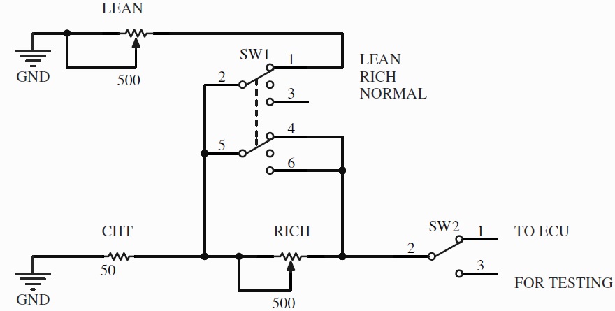

I know the feeling. Here's a little spin on your updated circuit to have a rich, lean, and normal setting. Using all the same components as you did except using a center off DPDT switch.
When SW1 is in the up position, the CHT is set for lean operation. In the center (OFF) position, the CHT is set for rich operation. In the down position, the CHT is normal.
DPDT Switch ON-OFF-ON
Good idea, I didn't know such a switch existed! You can do the same with mine by adjusting the rich pot to be a shunt, but this is better.
