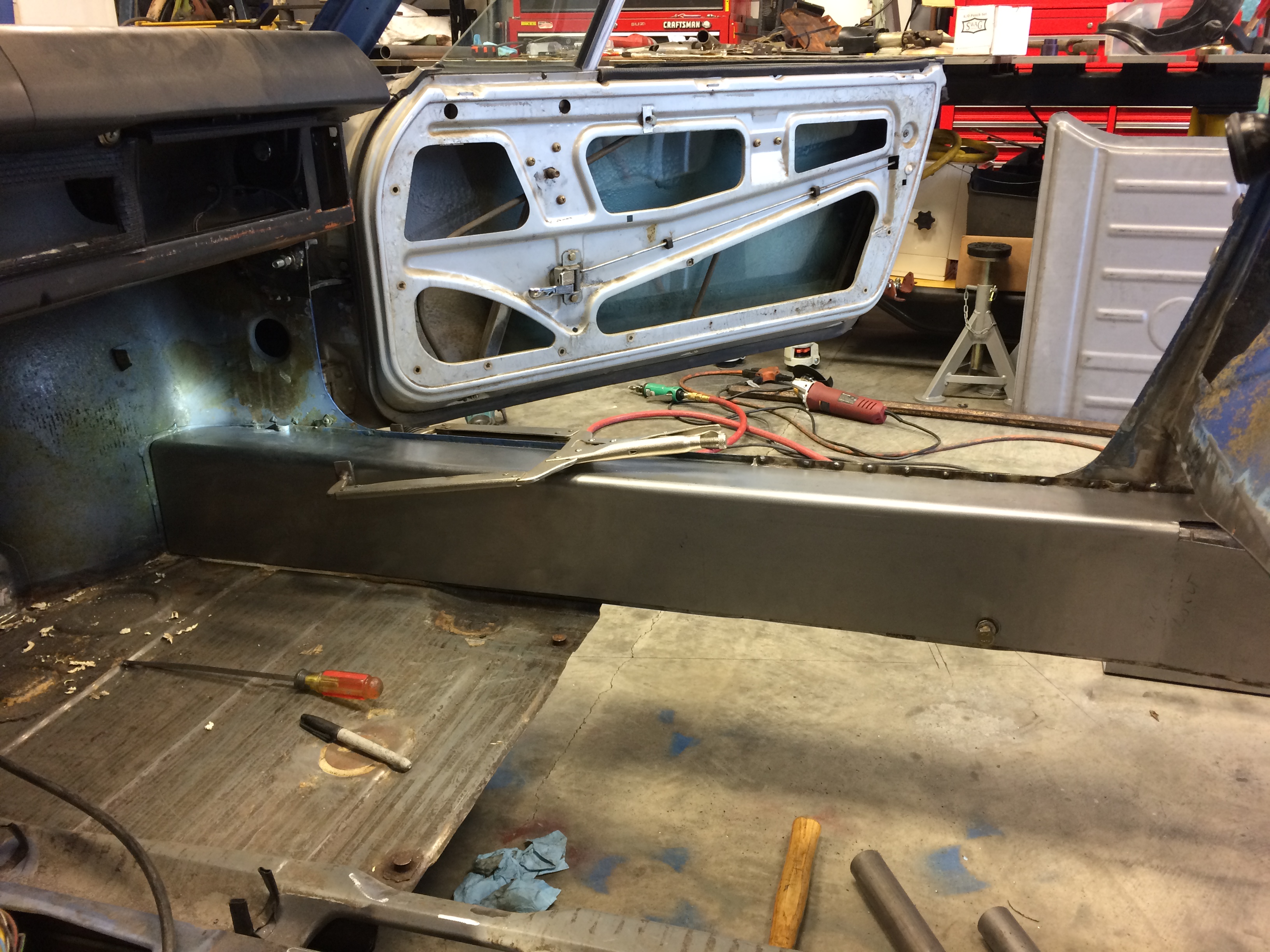

CHASSIS STIFFENING: Inner Longs
Got started on the inner long stiffener. Since I deleted the heater tubes, I'm going to skin the long "everywhere". And trying to keep it tight. I like the clean look!
Given the way the longs change shape behind the firewall, I'm planning to make each side in two pieces: the part seen here, and the second part for the "up the long" part.
That part will be more complex and I'm going to have to wait til I cut the suspension consoles out to prep for the Tangerine Racing raised pick up kit.
