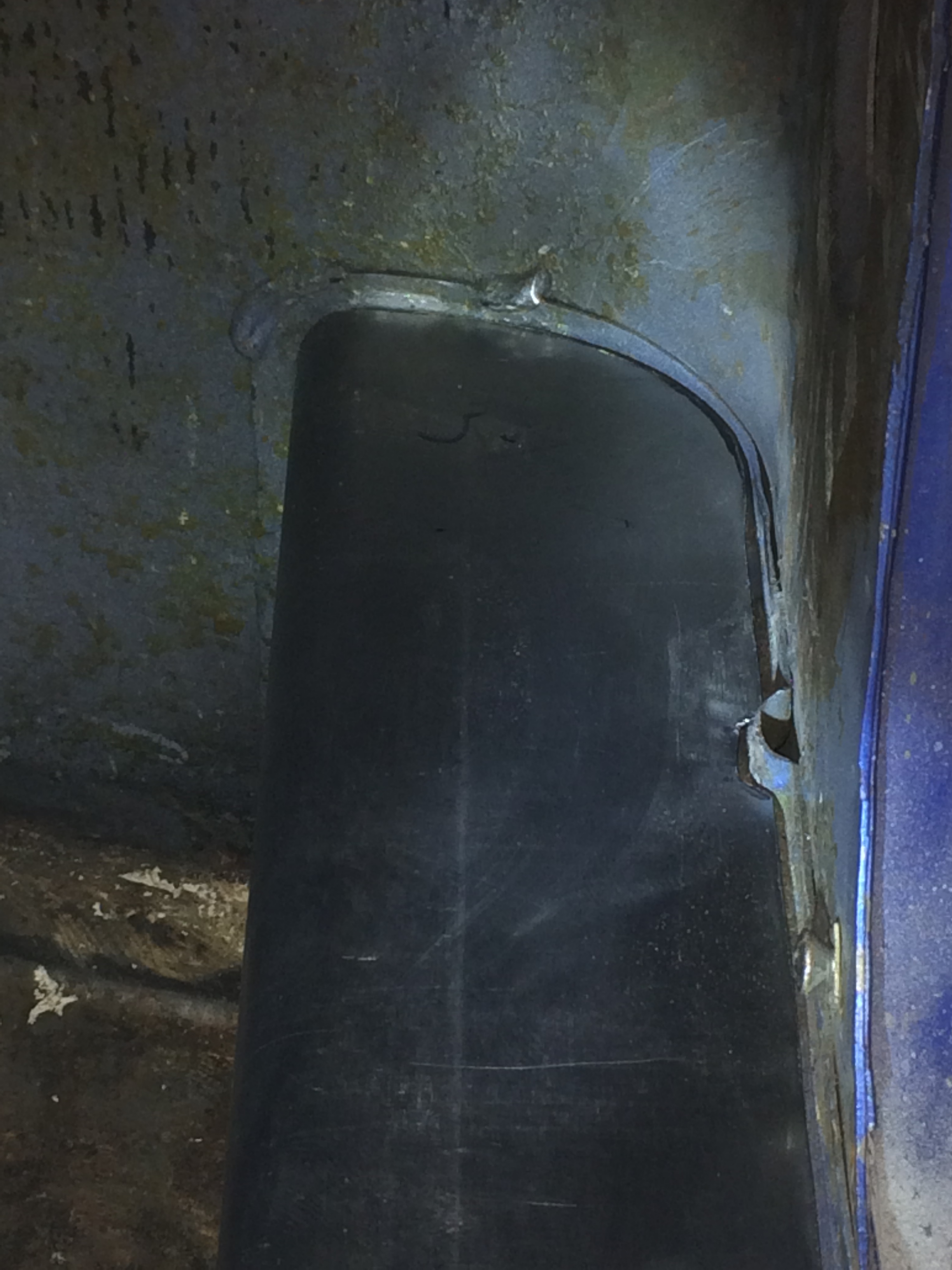

Details, details... trim to fit - even the little weep hole thingy.
Yes, it'll be hidden under carpet but I know it's the way I wanted it. (IMG:style_emoticons/default/shades.gif)
