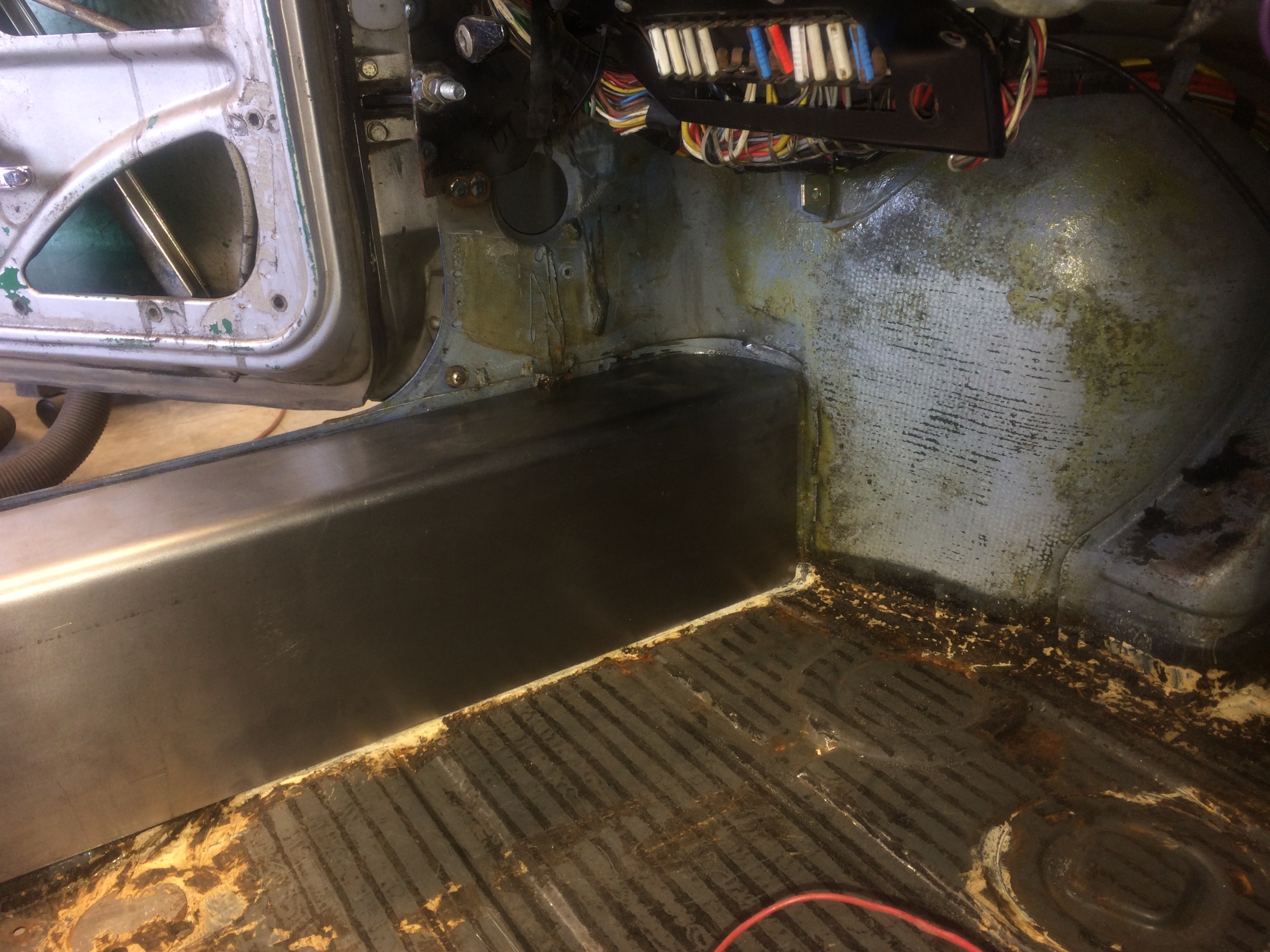

tygaboy   CHASSIS STIFFENING: Inner Longs Got started on th...   Oct 29 2016, 10:01 AM
Mueller   CHASSIS STIFFENING: Inner Longs Got started on t...   Oct 29 2016, 10:05 AM
tygaboy   Details, details... trim to fit - even the little ...   Oct 29 2016, 10:04 AM
tygaboy   Fitting the left side... This went way faster as I...   Oct 29 2016, 06:13 PM
Rand   Nice. You don't need a bunch of tubage. This a...   Oct 29 2016, 06:17 PM
tygaboy   Nice. You don't need a bunch of tubage. This ...   Oct 29 2016, 06:24 PM
Rand   Nice. You don't need a bunch of tubage. This...   Oct 29 2016, 06:35 PM
