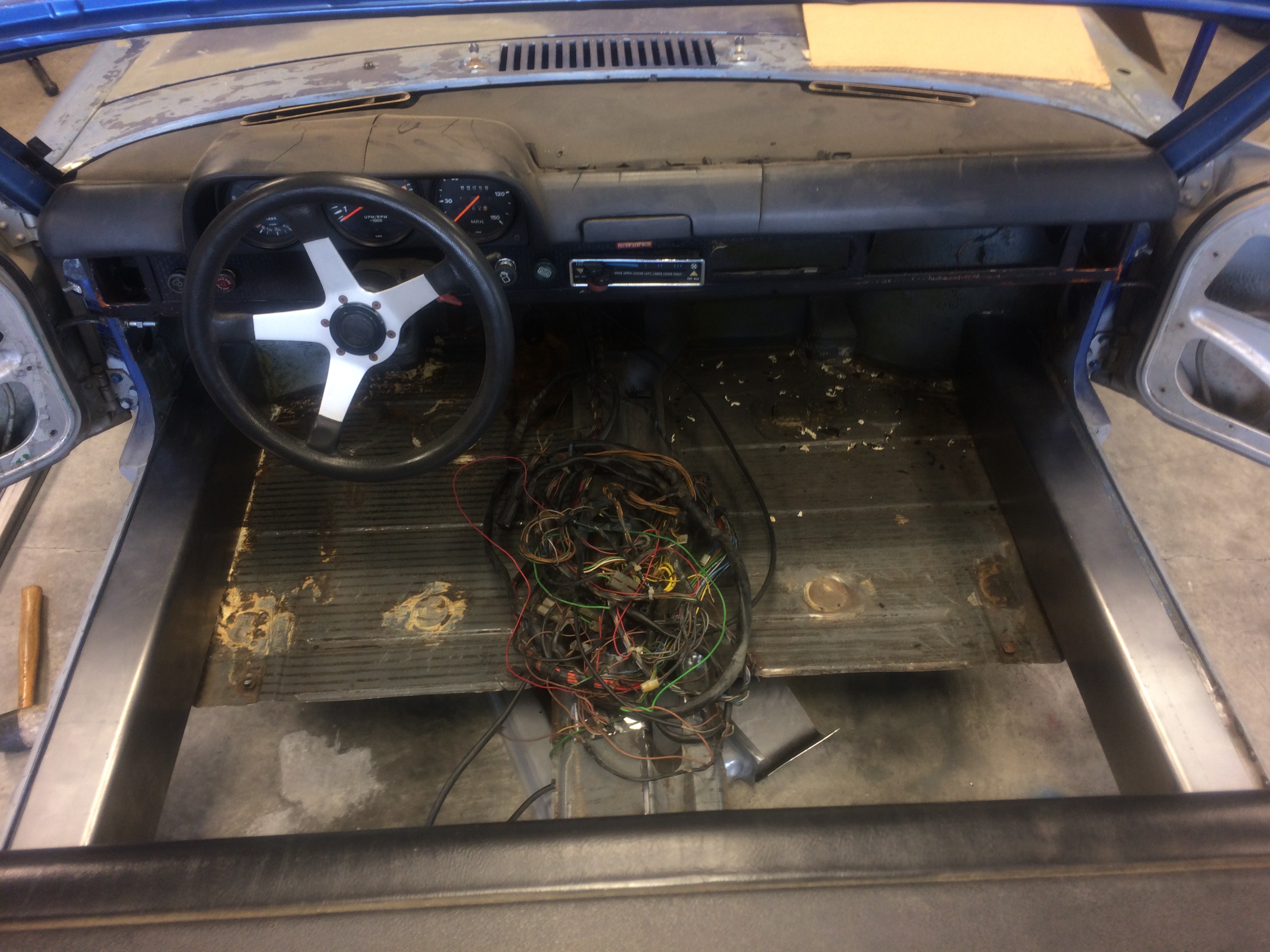

tygaboy
post Oct 29 2016, 06:20 PM
Posts: 5,859
Joined: 6-October 15
From: Petaluma, CA
Member No.: 19,241
Artsy shot of the day. I just love the smooth, clean look! Now to mess it all up with hole drilling and plug welding. Ah well, it'll get covered up at some point anyway.
