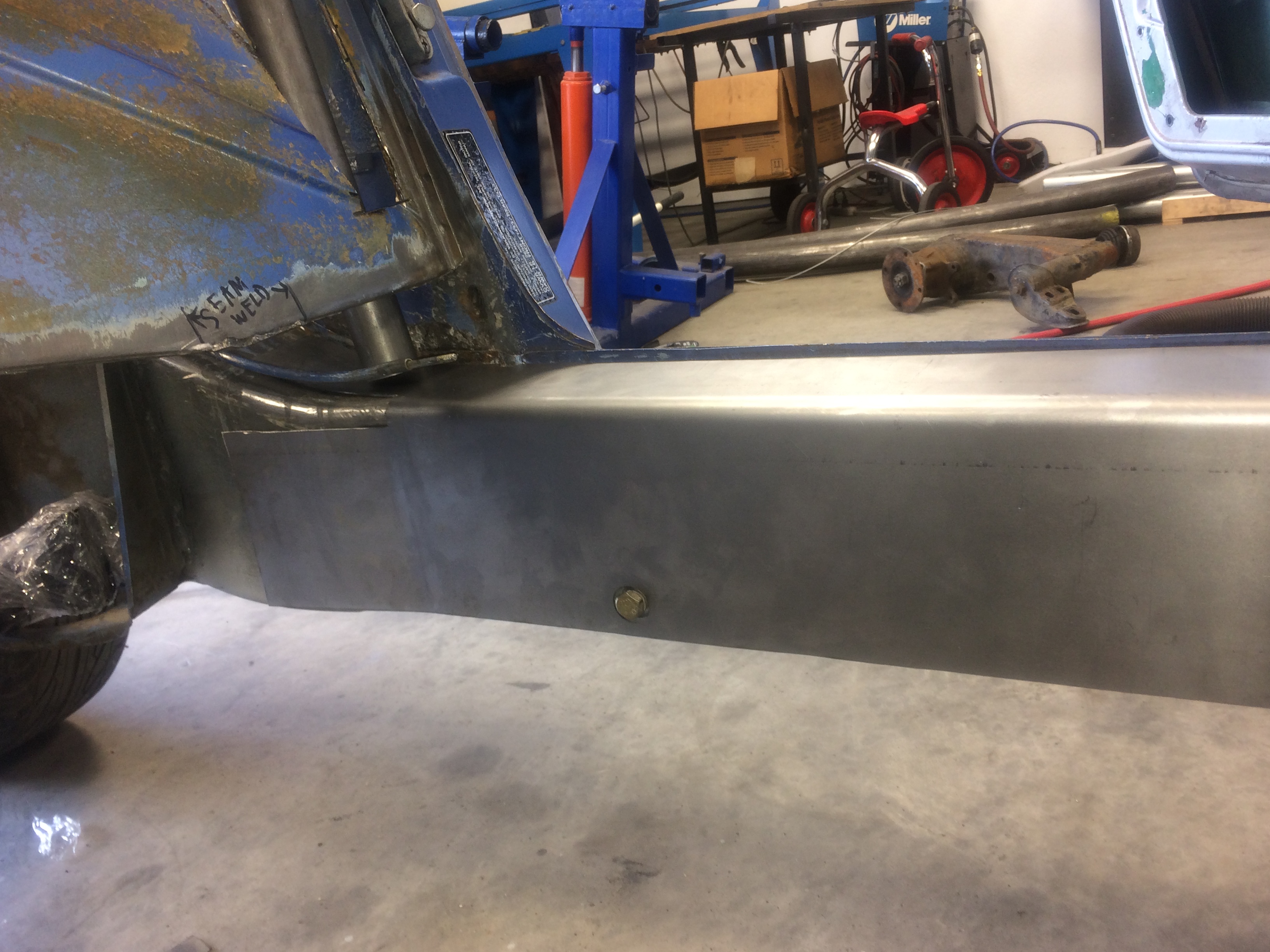

tygaboy   The outer longs? Pretty nice! No problem! ...   Oct 17 2016, 11:07 AM
tygaboy   Forgot the pic of the outer longs...   Oct 17 2016, 11:08 AM

tygaboy   In planning the fabrication of the sleeves needed ...   Oct 17 2016, 01:00 PM
tygaboy   I sliced the longitudinal repair section out of my...   Oct 17 2016, 01:11 PM

tygaboy   Hell hole/long repair welding nearly completed...   Oct 17 2016, 02:01 PM
tygaboy   My paranoia paid off and another Tangerine product...   Oct 17 2016, 02:10 PM
