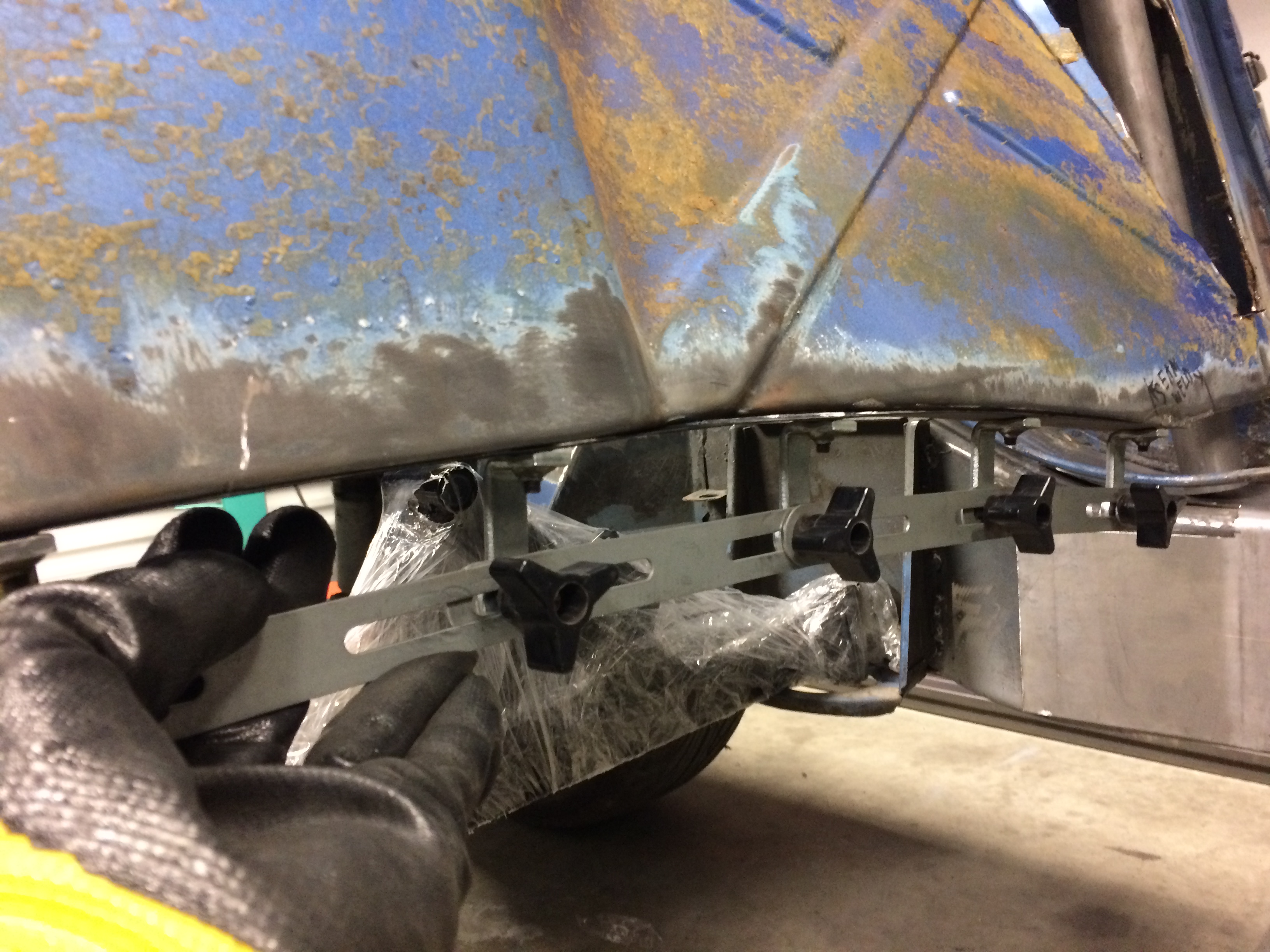

Today's realization is that this really is a jigsaw puzzle. And I've determined I want to have all the pieces before I start putting any of it together.
So... My stiffening plan includes a tunnel from the firewall to the front roll hoop. Since this will tie into the lower firewall and it's all the way out, this is an opportunity to beef up that area of the chassis, too.
I was planning to run a bar across from long to long and sandwich that between the stock inner and outer firewall sheet metal. But with some additional head scratching and input from my race car fab buddy, Martin, I've decided to build a more substantial structure. Similar to what MichiganMat has done on his build.
If you haven't figured it out yet, I love curves. Arches are pretty strong, too.
Roll bender to the rescue! This is a different one from the one I used to roll the round tube. It's purpose build for flat/square stock. I got it for free and it saves me buying additional dies for the Swag Offroad roll bender.
So instead of running a straight tube across and running sheetmetal from the upper firewall down to the tube, I'm going to roll a square tube that fits right up against that curved lower edge.
First, I used the curve template tool to capture the radius I need. I was surprised at just how much arch there is.
