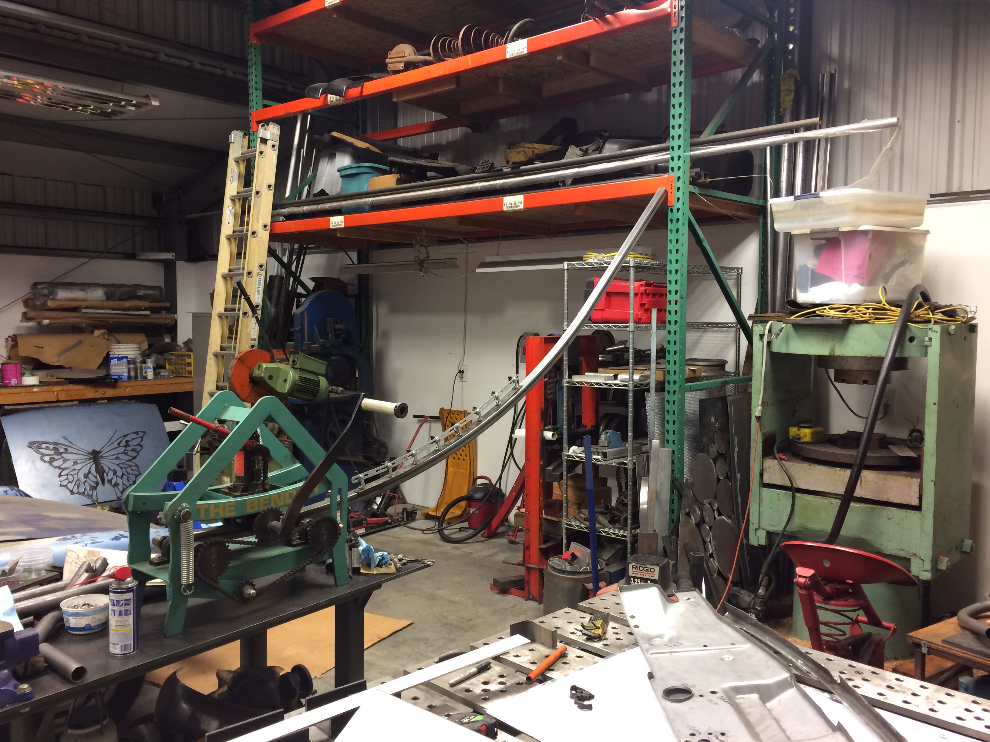

Then it's roll, check, roll, check. Manual roll bending 1.5" .095 wall tubes is a pretty good work out, too!
This pic reminded me how fortunate I am to have a high ceiling in the shop.

tygaboy   CHASSIS STIFFENING: Lower Firewall Today's re...   Oct 30 2016, 09:53 AM
tygaboy   Then it's roll, check, roll, check. Manual rol...   Oct 30 2016, 09:55 AM
tygaboy   Looks good to me!   Oct 30 2016, 09:56 AM
