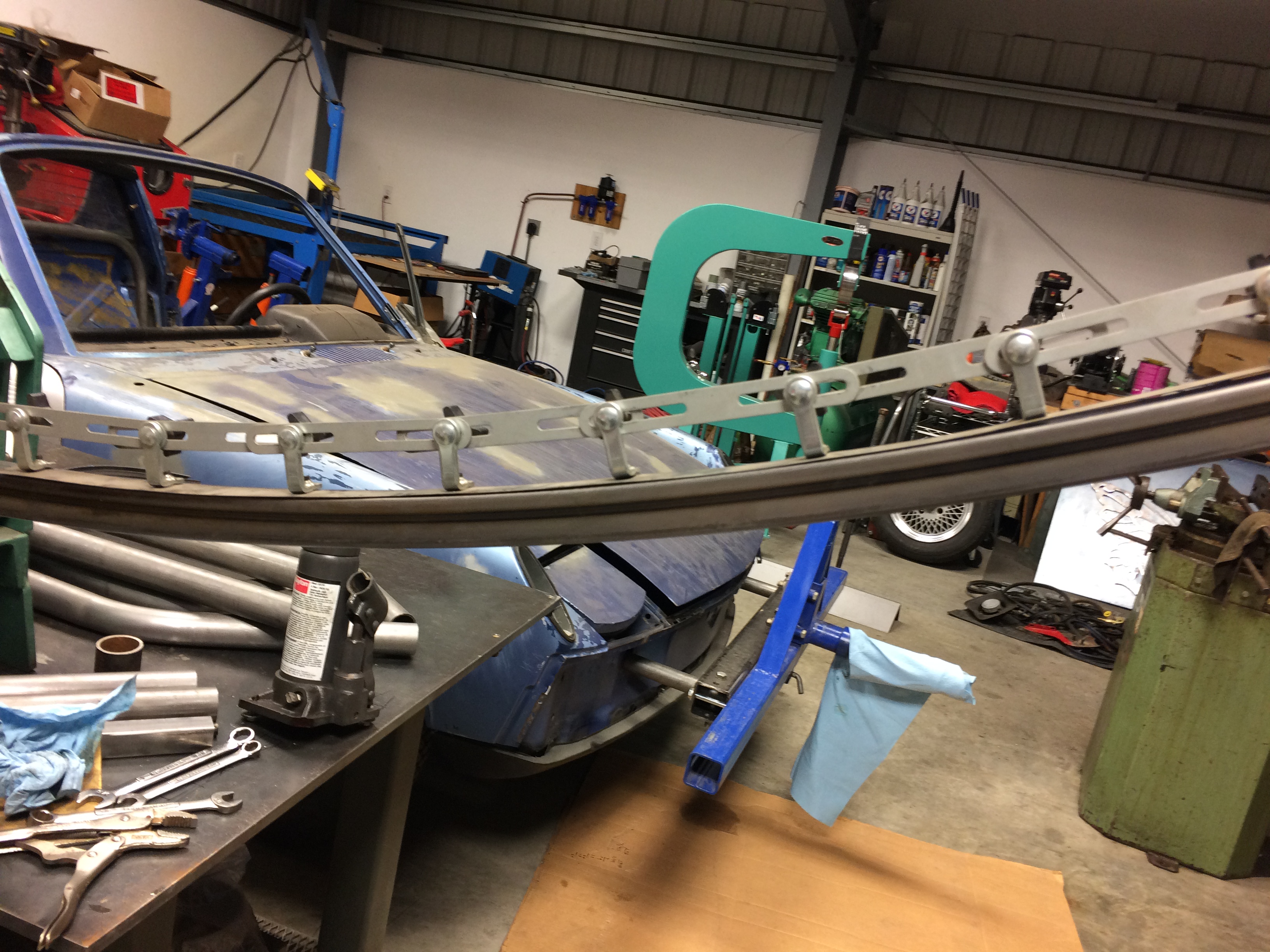

tygaboy   CHASSIS STIFFENING: Front Hoop/Door Bars In keepi...   Oct 23 2016, 01:42 PM
tygaboy   CHASSIS STIFFENING: Con'd Next, I started on ...   Oct 23 2016, 01:51 PM
Rand   I don't think you need three verts. My choice ...   Oct 23 2016, 02:00 PM
Cracker   Chris - You don't need to have your bar that h...   Oct 23 2016, 03:39 PM
tygaboy   Chris - You don't need to have your bar that ...   Oct 23 2016, 05:26 PM
