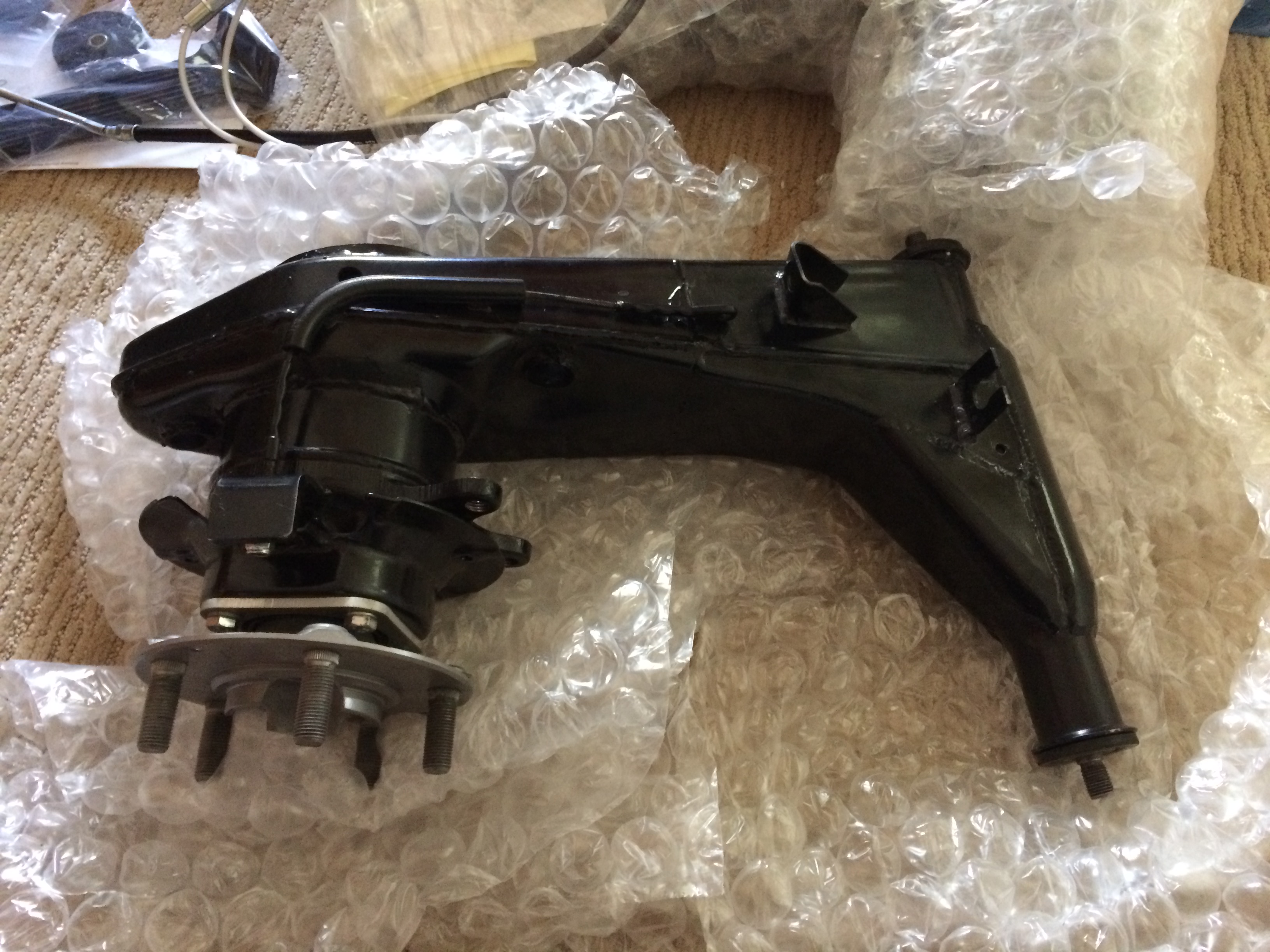

tygaboy
post Oct 30 2016, 06:37 PM
Posts: 5,859
Joined: 6-October 15
From: Petaluma, CA
Member No.: 19,241
Suspension porn! Got my trailing arms back from Chris at Tangerine Racing:
stiffened, gussets, 911 e-brake assembly, hub-centric Carerra hubs, Elephant bushings, etc.
(IMG:style_emoticons/default/wub.gif)

tygaboy   Suspension porn! Got my trailing arms back fro...   Oct 30 2016, 06:37 PM
Cracker   Damn right those are slick...Foley does excellent ...   Oct 30 2016, 06:47 PM
