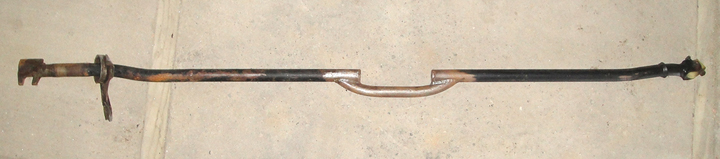

I know you are talking side shifter..
but here is an original 6 tail shift rod that was
cut to use in a car with an early 1965 engine.
Pretty serious mod, but it shifted fine.
