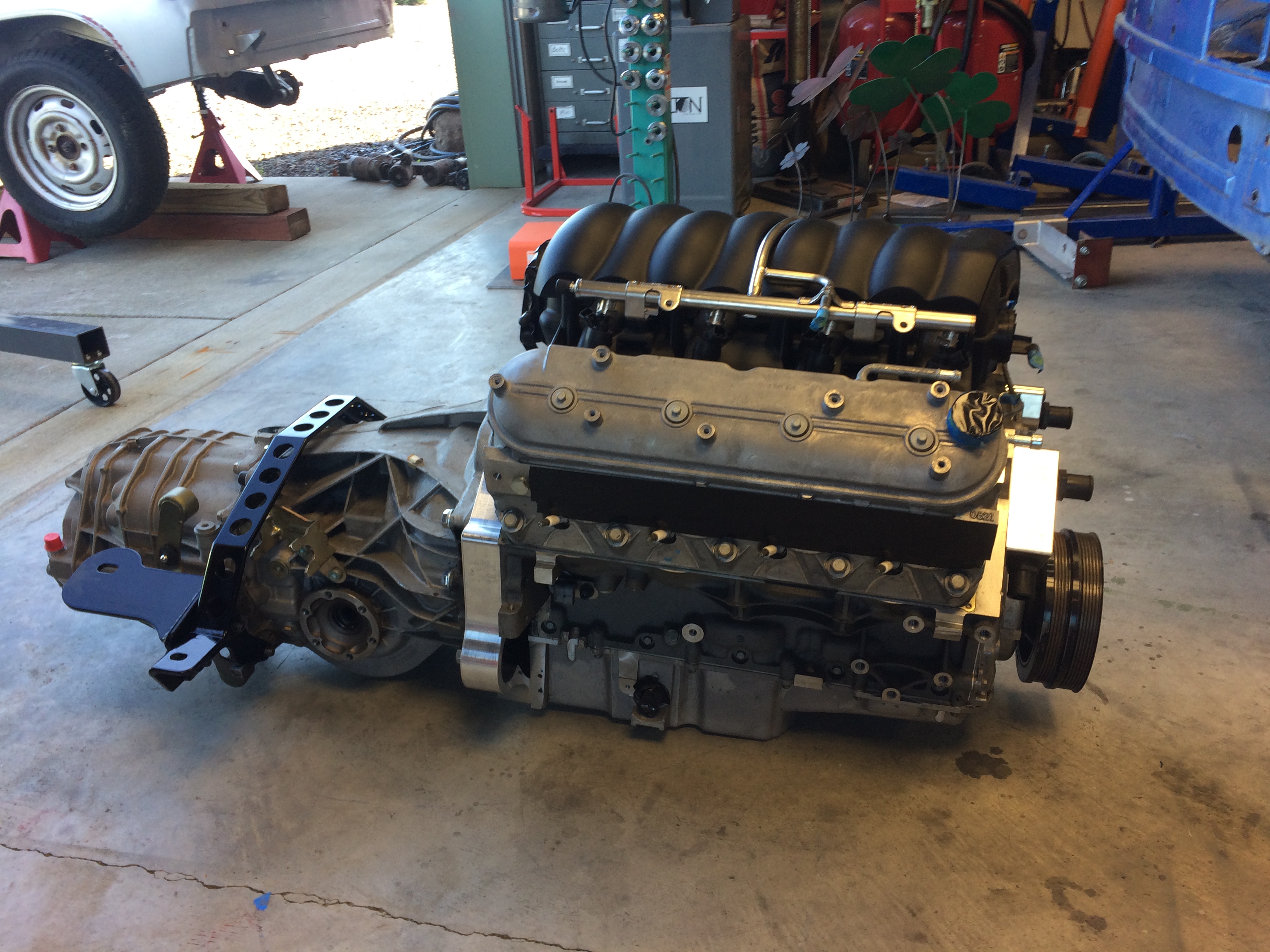

November activities commence with some new stuff: Engine and trans mock up install!
LS3/Boxster 6 set ups create pretty high CV angles and in detailed conversation with Tony (Cracker), not to mention his subtle hinting a few posts back (IMG:style_emoticons/default/biggrin.gif) , I'm taking his advice and mocking up the drive train before finalizing my firewall mods.
As you know, I have Tony's "old" LS3 engine. He used his considerable Southern charm and talked me into buying it. (OK, not much taking into required!). I figured it would save some time as it had already been proven in a 914 install, the intake was already flipped, it had low miles and I'd seen/heard video of it running.
Next, I purchased the Renegade Hybrids LS kit and their 6-speed kit. This was all maybe about a year ago. But after all that time, today was the first time I unpacked everything. It was like Christmas!
Gotta say, the Renegade stuff is really nice. Fit and finish is impressive.
I didn't install the flywheel and clutch as this phase is all about determining clearances and deciding if I want to do things like move the motor forward to, at least partially, address the CV angle.
Engine, meet Trans. Trans, Engine! (IMG:style_emoticons/default/grouphug.gif)
