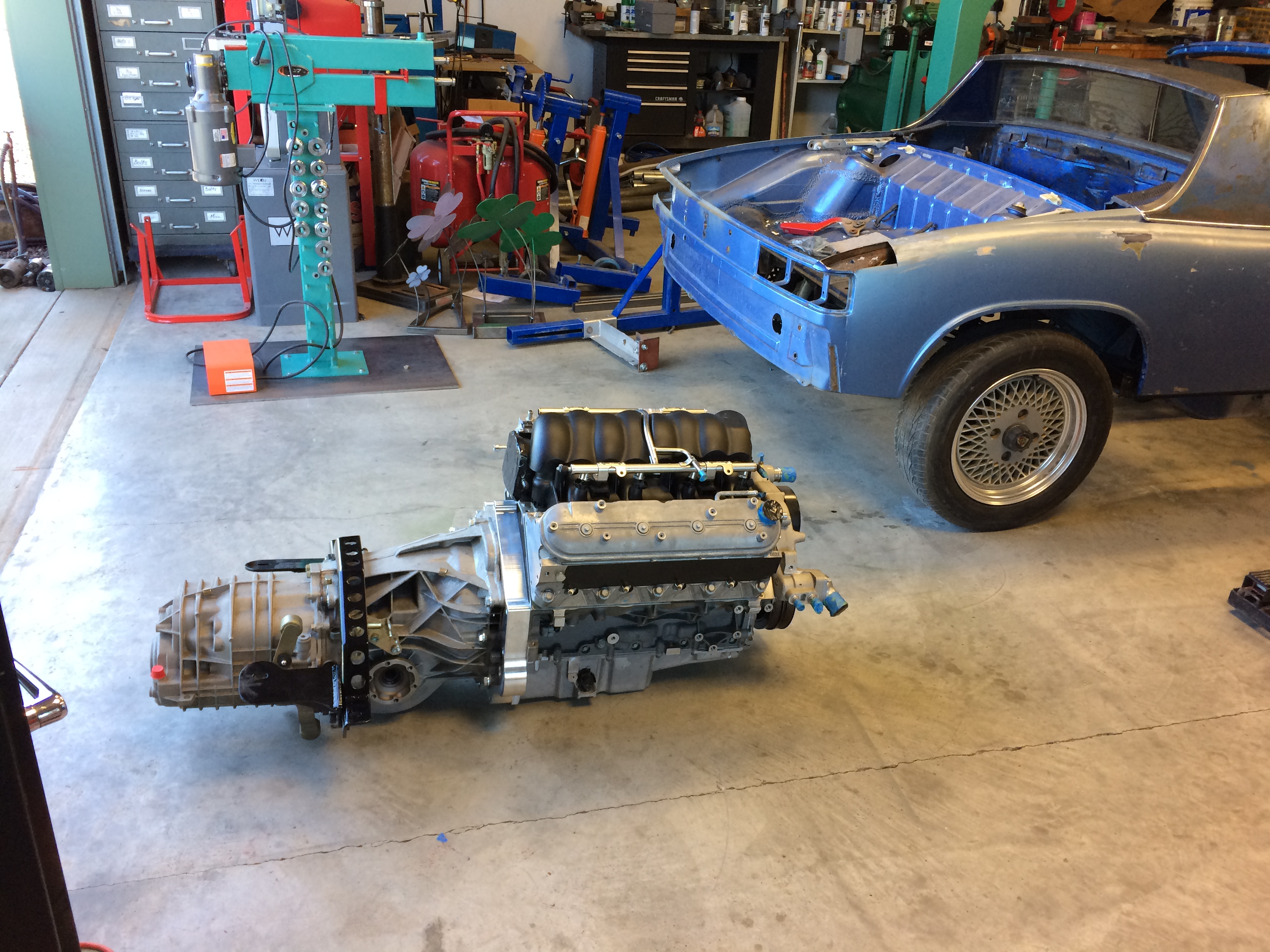

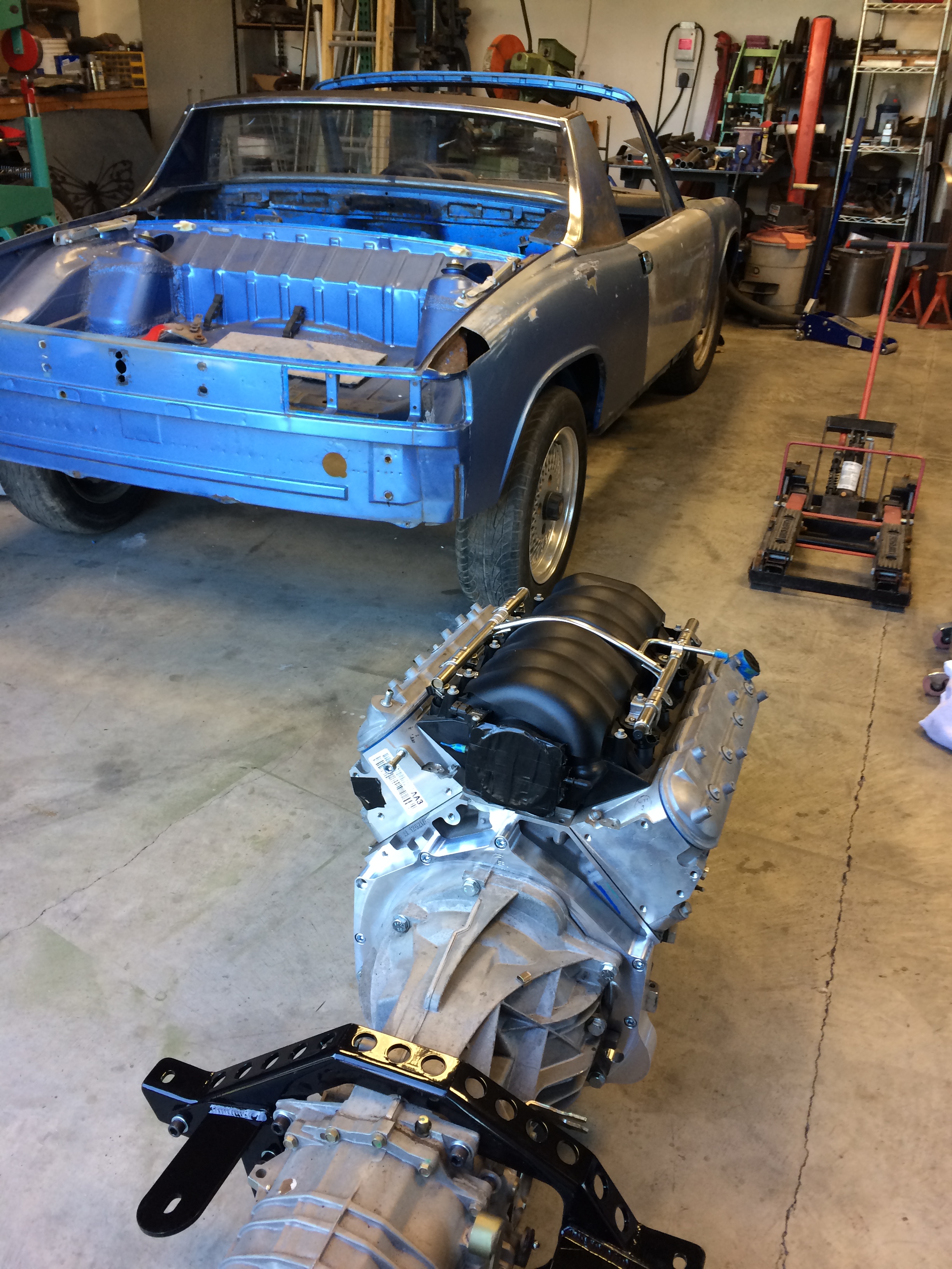

tygaboy   Engine & Trans: Mock Up November activities c...   Nov 4 2016, 05:22 PM
tygaboy   As I'm looking at this wild set up, I leaned u...   Nov 4 2016, 05:27 PM
